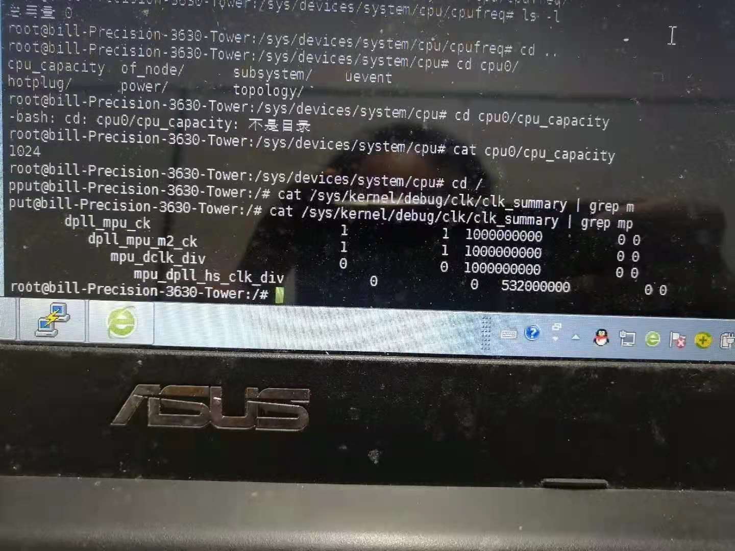

     我们正在采用AM5718开发产品,通过cat /sys/kernel/debug/clk/clk_summary | grep mpu 发现CPU的频率只有1GHZ,请问如何让CPU跑到1.5GHZ,BOOT和内核是否都需要修改?

               按您链接文档修改如下,发现速度反而变慢了,恳请帮忙分析一下,谢谢!
    1:修改hw_data.c文件以下内容:
    struct dplls dra72x_dplls = {
    .mpu = mpu_dpll_params_1_5ghz,      //原始为mpu_dpll_params_1ghz
    .core = core_dpll_params_2128mhz_dra7xx,
    .per = per_dpll_params_768mhz_dra7xx,
    .abe = abe_dpll_params_sysclk2_361267khz,
    .iva = iva_dpll_params_2330mhz_dra7xx,
    .usb = usb_dpll_params_1920mhz,
    .ddr = ddr_dpll_params_2664mhz,
    .gmac = gmac_dpll_params_2000mhz,
    2:新增:
    /* OPP HIGH FREQUENCY for ES2.0 */
    static const struct dpll_params mpu_dpll_params_1_5ghz[NUM_SYS_CLKS] = {
    {125, 0, 1, -1, -1, -1, -1, -1, -1, -1, -1, -1}, /* 12 MHz */
    {-1, -1, -1, -1, -1, -1, -1, -1, -1, -1, -1, -1}, /* 13 MHz */
    {625, 6, 1, -1, -1, -1, -1, -1, -1, -1, -1, -1}, /* 16.8 MHz */
    {625, 7, 1, -1, -1, -1, -1, -1, -1, -1, -1, -1}, /* 19.2 MHz */
    {750, 12, 1, -1, -1, -1, -1, -1, -1, -1, -1, -1}, /* 26 MHz */
    {-1, -1, -1, -1, -1, -1, -1, -1, -1, -1, -1, -1}, /* 27 MHz */
    {625, 15, 1, -1, -1, -1, -1, -1, -1, -1, -1, -1} /* 38.4 MHz */
    变慢后的结果为:
