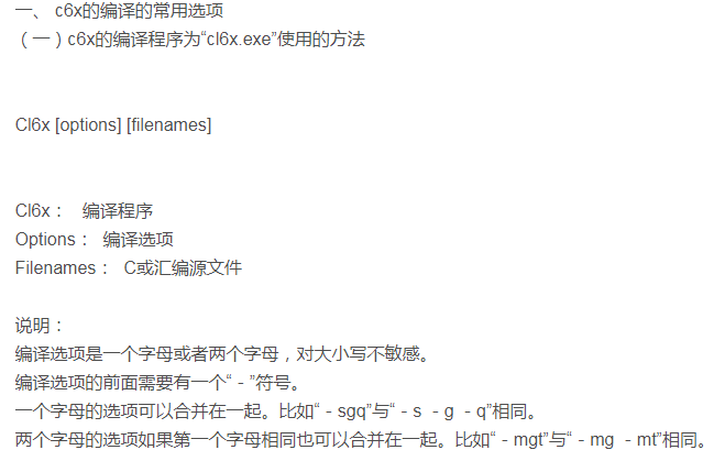

请问网上说的这个cl6x.exe在CCS5.5中可以用吗,应该怎么用
  • 在ccs中不需要使用cl6x.exe来编译程序。
    如果不使用IDE来编译程序,可以使用,可参考:
    2.2 Compiling from the Command Line
    The compiler is a command-line program named cl6x. This program can compile, optimize, assemble, and
    link programs in a single step. Within Code Composer Studio, the compiler is run automatically to perform
    the steps needed to build a project.
    www.ti.com/.../sprui04b.pdf
