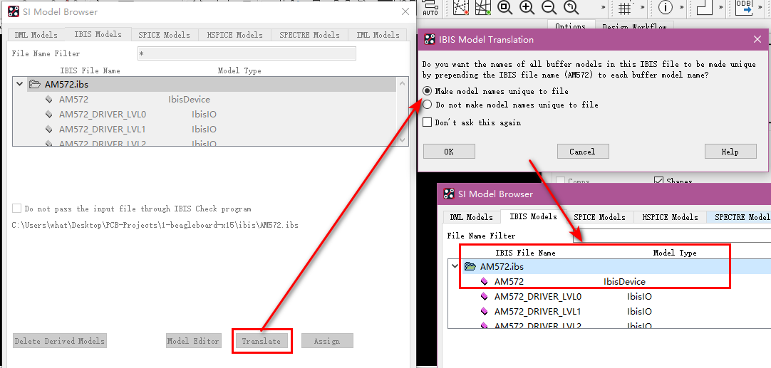

下载 AM5728 ibis模型 translate 后,SI Model Browser 中的ibis file name 有多个模型可供选择,如何选择正确的模型?
[Pin] signal_name model_name R_pin L_pin C_pin
Y10 ATESTV NC
G19 DCAN1_RX Selector_10 0.142301 1.81835E-09 4.38728E-13
G20 DCAN1_TX Selector_10 0.137913 1.91785E-09 4.43391E-13
| Usage I/O#1.8/3.3###BC1833DV40DCPBFBP1811_SSCEV.PAD
| Base model BC1833DV40DCPBFBP1811_SSCEV
[Model Selector] Selector_10
Model_736 I/O,1.8V,40D CLASS MODE FAST MODE,IND,10 PERCENT%,BC40D_V_10P_!SC1_1P8
Model_737 I/O,1.8V,40C CLASS MODE SLOW MODE,IND,10 PERCENT%,BC40D_V_10P_SC1_1P8
Model_738 I/O,1.8V,40D CLASS MODE FAST MODE,IND,5 PERCENT%,BC40D_V_5P_!SC1_1P8
Model_739 I/O,1.8V,40C CLASS MODE SLOW MODE,IND,5 PERCENT%,BC40D_V_5P_SC1_1P8
Model_740 I/O,3.3V,40D CLASS MODE FAST MODE,IND,10 PERCENT%,BC40D_V_10P_!SC1_3P3
Model_741 I/O,3.3V,40C CLASS MODE SLOW MODE,IND,10 PERCENT%,BC40D_V_10P_SC1_3P3
Model_742 I/O,3.3V,40D CLASS MODE FAST MODE,IND,5 PERCENT%,BC40D_V_5P_!SC1_3P3
Model_743 I/O,3.3V,40C CLASS MODE SLOW MODE,IND,5 PERCENT%,BC40D_V_5P_SC1_3P3
