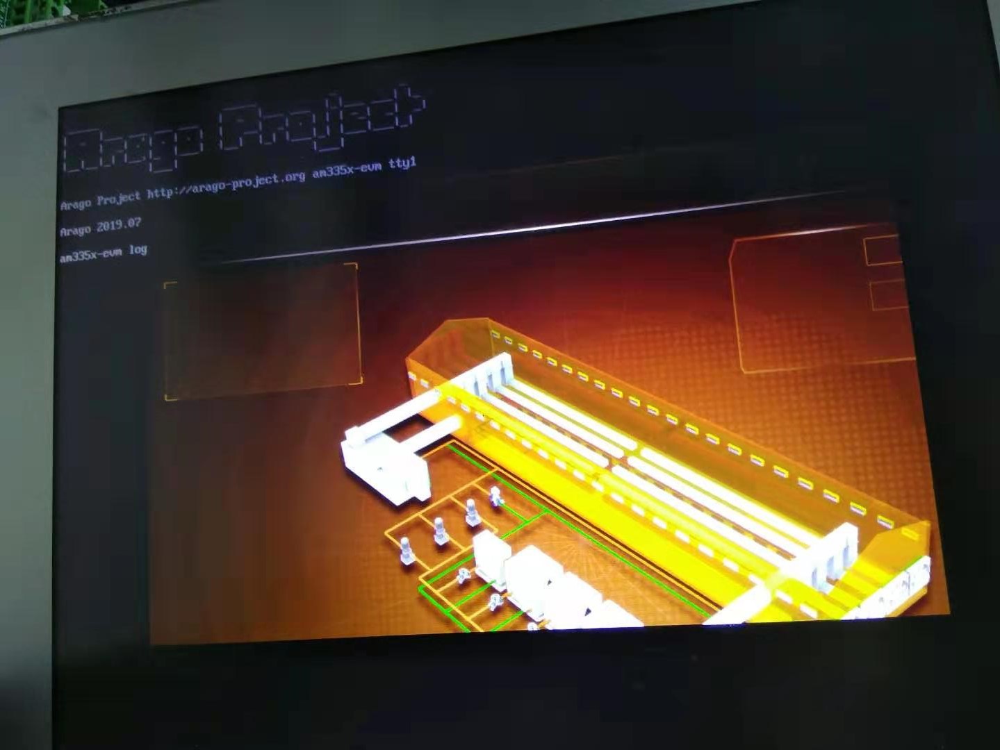

最近使用am335x驱动友达的12寸触摸屏 auo G121XN01,出现无法正常显示图像的问题,使用的是ti-processor-sdk-linux-am335x-evm-06.01.00.08,白色字是登录输出,图片是自己编写的qt程序,图片显示不全,而且颜色(图片为蓝底)显示不对,以下是设备树的信息

以下是启动log,出现了tilcdc 4830e000.lcdc: no encoders/connectors found 问题
1.030454] omap_rng 48310000.rng: Random Number Generator ver. 20
[ 1.038756] random: fast init done [ 1.042501] random: crng init done
[ 1.047002] OF: graph: no port node found in /ocp/lcdc@4830e000
[ 1.053357] OF: graph: no port node found in /ocp/lcdc@4830e000
[ 1.059962] OF: graph: no port node found in /ocp/lcdc@4830e000
[ 1.065930] tilcdc 4830e000.lcdc: no encoders/connectors found
