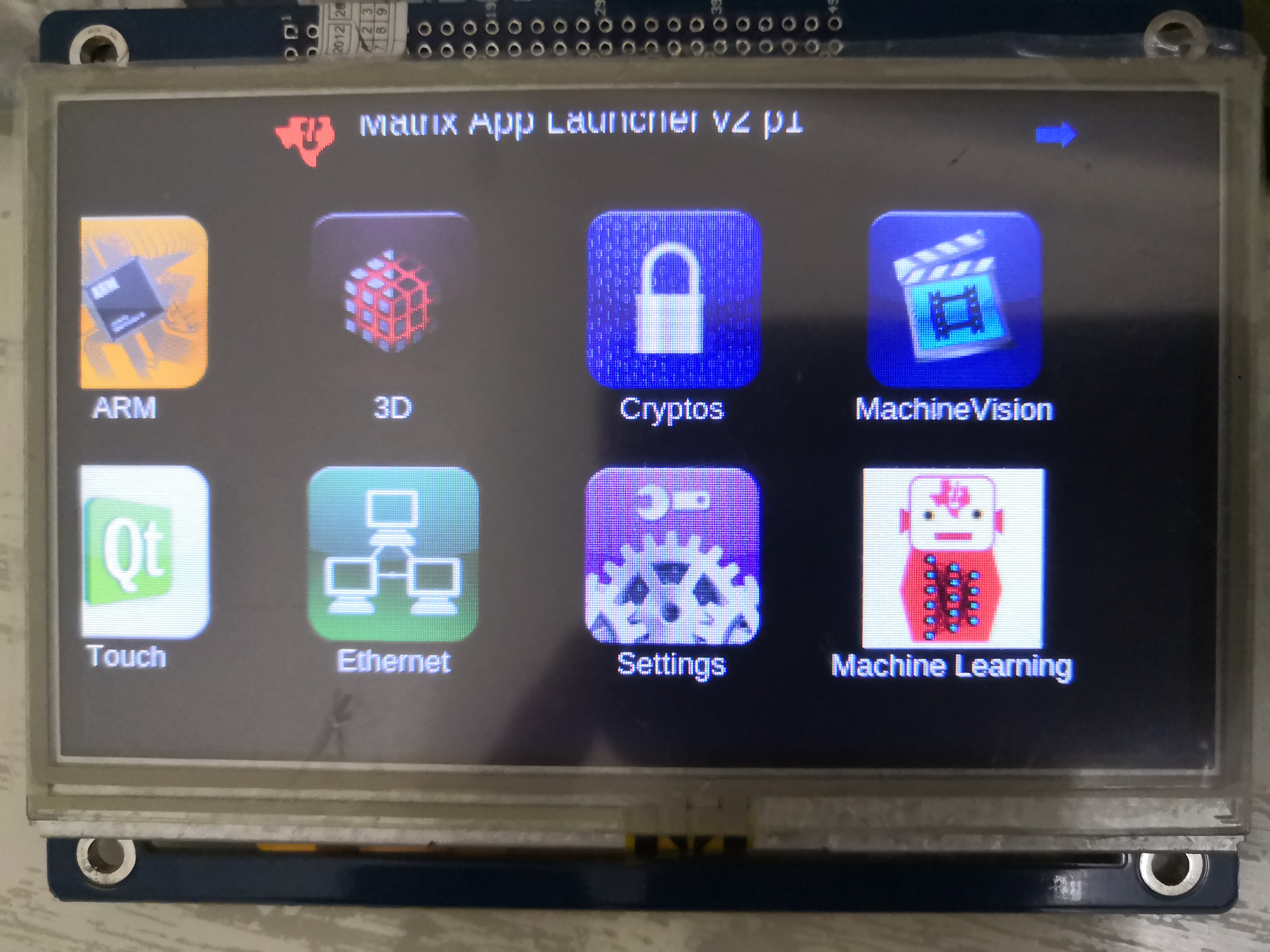

Beaglebone Black扩展4.3寸电阻触摸屏matrix-gui显示和触摸不正常
硬件:Beaglebone Black,自制LCD扩展板,4.3寸4线电阻触摸屏
软件:Processor SDK Linux 06_03_00_106
使用最新tisdk编译出的image、rootfs,设备树已添加4.3寸触摸屏支持,SD卡启动后,matrix显示界面不完整,触摸操作也不能用,按照官方文档重新校准后还是不能用,界面如下
Beaglebone Black终端里输入命令:cat /dev/input/event0 | hexdump -C 然后按下触摸屏也有数据,判断触摸驱动应该没问题。
通过 cat /var/log/weston.log 查看weston 日志如下:

[02:11:02.514] event0 - ti-tsc: is tagged by udev as: Touchscreen
[02:11:02.514] event0 - ti-tsc: device is a touch device
[02:11:02.515] Touchscreen - ti-tsc - /sys/devices/platform/ocp/44e0d000.tscadc/TI-am335x-tsc.0.auto/input/input0/event0
[02:11:02.515] input device event0 has no enabled output associated (none named), skipping calibration for now.

[02:11:02.519] associating input device event0 with output LVDS-1 (none by udev)
[02:11:02.521] Warning: input device event0 has WL_CALIBRATION property set. Support for it will be removed in the future. Please use LIBINPUT_CALIBRATION_MATRIX instead.
[02:11:02.521] input device event0: applying calibration:
1.093177 0.031752 -0.062550
-0.005434 1.128473 -0.069518
raw translation -30.023804 -18.908844 for output LVDS-1

[02:11:14.436] notify_touch: weston_compositor_pick_view(159, 273) failed to find a view!
请教这是什么问题,matrix显示不完整,触摸也不起作用!
  • 是参照这个校准的
    BBB板终端执行 rm /etc/udev/rules.d/ws-calibrate.rules;reboot 后重启进入校准界面,校准完成后,触摸还是没反应。
    另外教程中触摸屏校准一节提到的命令 rm /run/media/mmcblk0p1/ws-calibrate.rules 这个文件不存在

  • 通过修改dts中display-timings参数,屏幕显示正常了,但是进入Matrix App Launcher v2 p1这个主界面,触摸还是没有反应。
    通过evtest 测试触摸屏输出如下:

    Event: time 1587262524.390976, type 3 (EV_ABS), code 0 (ABS_X), value 810
    Event: time 1587262524.390976, type 3 (EV_ABS), code 1 (ABS_Y), value 1570
    Event: time 1587262524.390976, type 3 (EV_ABS), code 24 (ABS_PRESSURE), value 24 1
    Event: time 1587262524.390976, -------------- SYN_REPORT ------------
    Event: time 1587262524.392902, type 3 (EV_ABS), code 0 (ABS_X), value 777
    Event: time 1587262524.392902, type 3 (EV_ABS), code 1 (ABS_Y), value 1574
    Event: time 1587262524.392902, type 3 (EV_ABS), code 24 (ABS_PRESSURE), value 24 3
    Event: time 1587262524.392902, -------------- SYN_REPORT ------------
    Event: time 1587262524.403211, type 1 (EV_KEY), code 330 (BTN_TOUCH), value 0
    Event: time 1587262524.403211, type 3 (EV_ABS), code 24 (ABS_PRESSURE), value 0
    Event: time 1587262524.403211, -------------- SYN_REPORT ------------
