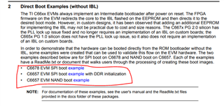

请参考过 2 Direct Boot Examples (without IBL) :
