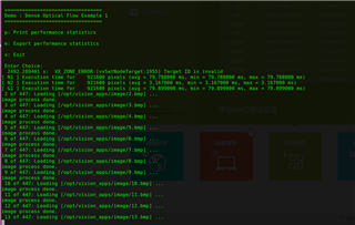

TDA4VM: after add vxHarrisCornersNode, the program is block in 13 frame
Part Number: TDA4VM
program data flow design is above, without the optical flow node, program is work normaly.
But when i add the opticalflow node, the program will block in the 3rd frame. my program is modify from the app_dof example.
opticalflow node cpp file is blow.

create node in main file
    if (status == VX_SUCCESS)
        status = app_create_graph_opticalflow(obj->graph, &obj->opticalflowObj,
                                   obj->pyramidObj.pyr_ref, obj->pyramidObj.pyr_cur,
                                   obj->harrisObj.har_ref,
                                   obj->harrisObj.har_cur,
                                   obj->opticalflowObj.eps,
                                   obj->opticalflowObj.num_iter,
                                   obj->opticalflowObj.use_estimations);
    if (obj->opticalflowObj.enable_temporal_predicton_flow_vector && (status == VX_SUCCESS))
        status = vxRegisterAutoAging(obj->graph, obj->opticalflowObj.corners_delay);
        status = tivxSetNodeParameterNumBufByIndex(obj->opticalflowObj.node, 4, num_buf);
the program will block in the 3rd frame when the pipeline > 0

tda4 run result above, the pipeline depth is set to 10, and the program is block in 13 frame.
