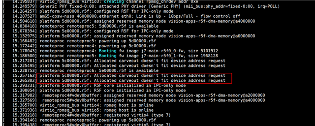

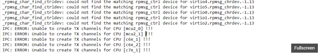

    I meet a problem when running vision_apps_init.sh, as shown in the figure below.

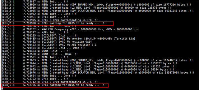

    After running vision_apps_init.sh, I run my app, and the following error occurred.
The premise of all these errors is that I updated the rootfs(PS:tisdk-default-image is regenerated from yocto and  firmware such as r5, c66 are generated based on the new image).
Finally, I carefully looked at the log at startup, and found that there was no print of the rpmsg_dev channel created as normal, as shown in the figure below.
Can anybody help me to figure out this problem?,
