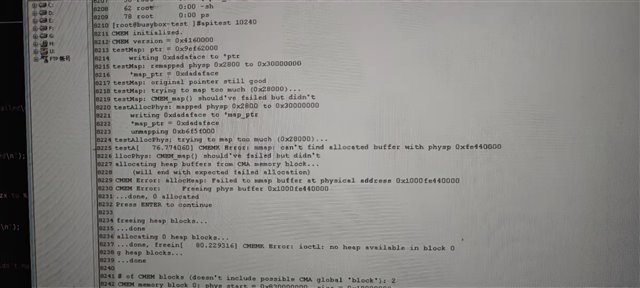

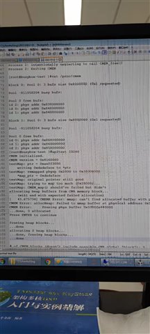

hello,
最近在做 66ak2h cmem模块的相关研究, insmod cmemk.ko正常,
但执行 apitest 时出现错误,不知道怎么定位问题。
错误现场如下图所示,
cmem版本为, cmem-mod-4.16.00.00+gitAUTOINC+4f970f053b

Apologies for the delayed response, Please refer this link in CMEM under api test : https://software-dl.ti.com/processor-sdk-linux/esd/docs/06_03_00_106/linux/Foundational_Components_CMEM.html
It seems api test has limited functionality and runs only on kernel built with "mem=120M".
