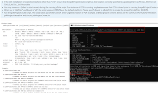

例程要执行命令生成。
1.4.5.1.5. PDK Example and Test Project Creation
https://software-dl.ti.com/processor-sdk-rtos/esd/docs/06_03_00_106/rtos/index_overview.html
