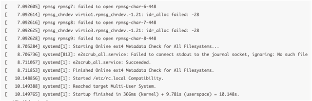

TDA4VM: The rpmsg_chrdev driver reported an error when IPC was used by different Linux processes
Part Number: TDA4VM
If different Linux processes call appCommonInit(), the RPMSG driver will report the following error, but IPC can communicate normally (A72<-->R5F).  If only one process calls appCommonInit() and another process does not call it, that process's IPC cannot be used  .
How to solve this driver error? Does it matter?

  • This is really a very strange error. Are the processes being run in parallel, or run back to back in real quick succession?
    appCommonInit() sets up the Rx and Tx end-points within thar process, so it definitely needs to be called for each process.
    The error -28 stands for ENOSPC, suggesting there is no free idr to allocate which should not happen with the parameters being passed (RPMSG_ADDR_ANY).
