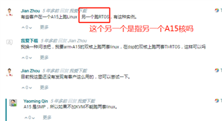

例如:核A15_0运行linux,核A15_1运行裸机程序或者RTOS的程序?
不好意思,请忽略之前的回复。
参考以下FAQ看一下:
How can I run TI RTOS on secondary ARM cores on multi-core ARM devices
谢谢回复。我浏览了里面相关的内容。其中有提到
Processor SDK RTOS supports multiple device that have multi-core ARM like AM572x and Keystone2 devices. In order to run TI RTOS application on the secondary ARM core in non-SMP mode, application developers need to add correct coreID to the configuration to their BIOS configuration to allow the hardware interrupts to be routed to the secondary core.
For example on AM572x which has 2 A15 cores, to run the TI RTOS example on secondary ARM core, application users need to add :
var Core = xdc.useModule('ti.sysbios.family.arm.ducati.Core');
Core.id = 1;
这个例子中第一个ARM core 是否也使用了,并且可以跑linux?
应该是指另一个A15。
说有这种使用方式,那有相关教程吗?
在提供的linux的SDK中需要配置什么?(SDK默认的编译应该是A15的2个核都使用了吧)
具体如何配置不熟悉,我会帮您升级到英文论坛。
