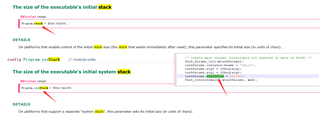

请教一下,在sysbios工程中这三个stack的区别是什么呢
program stack是代码需要的stack。
System stack:for hardware interrupts and software interrupts
task stack: If the Task module is enabled, SYS/BIOS creates an additional stack for each Task instance the application contains
