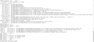

I am using SDK ti-processor-sdk-linux-j7-evm-08_00_00_08 display through HDMI and It works normal.
But I built rtos SDK(ti-processor-sdk-rtos-j721e-evm-08_00_00_12)  and installed to SD card, rootfs is default: ti-processor-sdk-linux-j7-evm-08_00_00_08/filesystem/tisdk-default-image-j7-evm.tar.xz, display through HDMI does't works. Run vision apps demo there is also no display through HDMI.
I have modified app_cfg_mcu2_0.h  vision_apps_build_flags.mak  and k3-j721e-vision-apps.dts as below,but it didnot work.
/////////////////////app_cfg_mcu2_0.h
#define  ENABLE_DSS_SINGLE
#undef ENABLE_DSS_DUAL
#undef ENABLE_DSS_EDP
#define ENABLE_DSS_HDMI
#undef ENABLE_DSS_DSI
#define ENABLE_I2C
#define ENABLE_BOARD
////////////////vision_apps_build_flags.mak
BUILD_ENABLE_ETHFW?=no
//////////////k3-j721e-vision-apps.dts(linux-sdk)
&main_i2c1 {
//status = "disabled";
Something else need to modify? Could I get some examples of HDMI display(RTOS SDK) ?
