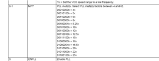

在SRIO的user guide的第23页有以下说明
Ability to run different ports at different baud rates (only integer multiple rates supported: 2.5G and 5G supported, 3.125G and 5G are not supported)
4个port只能支持有限个不同速率,5G是否支持?
