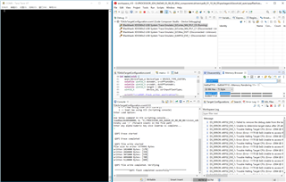

TI专家好,
当前我们在自己开发板上通过CCS或者QSPI方式均可以下载TDA3x固件,两种方式下启动串口的输出及配置选择还有一点问题想请教下:
1、Load From CCS

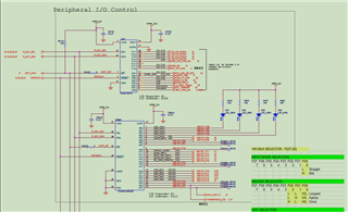

参考VisionSDK_UserGuide_TDA3xx.pdf,通过CCS方式,下载运行各核后,串口有输出及Usecases的配置选项如下图,但是我没有办法选择这几个选项,没有办法选择需要运行的use cases或者系统配置等,串口输出的Log如图片下的信息,Log中有出现“src/bsp_deviceI2c.c @ Line 667:
[IPU1-0] 41.161532 s: I2C0: DEV 0x20: ERROR !!!
[IPU1-0] 41.161623 s: src/bsp_deviceI2c.c @ Line 689:
[IPU1-0] 41.161715 s: I2C0: Error timeout 5000 ms!!!
[IPU1-0] 41.161776 s: src/bsp_boardTda3xx.c @ Line 2535:
[IPU1-0] 41.161867 s: I2C write failed!!
[IPU1-0] 46.163575 s: src/bsp_deviceI2c.c @ Line 667:
[IPU1-0] 46.163667 s: I2C0: DEV 0x20: ERROR !!!
[IPU1-0] 46.163758 s: src/bsp_deviceI2c.c @ Line 689:
[IPU1-0] 46.163850 s: I2C0: Error timeout 5001 ms!!!
[IPU1-0] 46.163941 s: src/bsp_boardTda3xx.c @ Line 2545:
[IPU1-0] 46.164002 s: I2C write failed!!
[IPU1-0] 51.165344 s: src/bsp_deviceI2c.c @ Line 667:
[IPU1-0] 51.165436 s: I2C0: DEV 0x23: ERROR !!!
[IPU1-0] 51.165527 s: src/bsp_deviceI2c.c @ Line 689:
[IPU1-0] 51.165619 s: I2C0: Error timeout 5001 ms!!!
[IPU1-0] 51.165710 s: src/bsp_boardTda3xx.c @ Line 1961:
[IPU1-0] 51.165771 s: I2C read failed!!
[IPU1-0] 51.165863 s: src/bsp_board.c @ Line 620:
[IPU1-0] 51.165924 s: Device select failed!!”
等错误,请问是这些问题导致的串口不能进行选择配置吗,该如何进行修改呢?

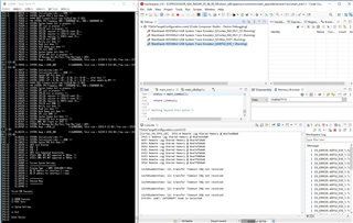

?鳾IPU1-0] 19.468187 s: ***** IPU1_0 Firmware build time 13:31:39 Nov 17 2021
[IPU1-0] 19.468340 s: *** SYSTEM: CPU Frequency <ORG = 212800000 Hz>, <NEW = 212800000 Hz>
[IPU1-0] 19.468584 s: SYSTEM: System Common Init in progress !!!
[IPU1-0] 19.475416 s: SYSTEM: IPC init in progress !!!
[IPU1-0] 19.475477 s: SYSTEM: IPCLIB init in progress !!!
[IPU1-0] 19.475660 s: SYSTEM: IPCLIB: register to [IPU1-1] event 15...
[IPU1-0] 19.475782 s: SYSTEM: IPCLIB: register to [DSP1] event 15...
[IPU1-0] 19.475843 s: SYSTEM: IPCLIB: register to [EVE1] event 15...
[IPU1-0] 19.475934 s: SYSTEM: IPCLIB init DONE !!!
[IPU1-0] 19.475995 s: SYSTEM: Notify init done !!!
[IPU1-0] 19.476148 s: SYSTEM: MsgQ init done !!!
[IPU1-0] 19.476361 s: SYSTEM: Work Queue init done !!!
[IPU1-0] 19.476422 s: SYSTEM: IPC init DONE !!!
[IPU1-0] 19.478344 s: SYSTEM: System Common Init Done !!!
[IPU1-0] 19.478405 s: SYSTEM: System Init in progress !!!
[IPU1-0] 19.478466 s: SYSTEM: BSP Common Init in progress !!!
[IPU1-0] 19.478527 s: SYSTEM: BSP Common Init Done !!!
[IPU1-0] 19.478618 s: SYSTEM: BSP Platform Init in progress !!!
[IPU1-0] 19.478740 s: PLATFORM: UNKNOWN CPU detected, defaulting to CPU REV 2.0
[IPU1-0] 19.478832 s: SYSTEM: BSP Platform Init Done !!!
[IPU1-0] 19.478893 s: SYSTEM: FVID2 Init in progress !!!
[IPU1-0] 19.478984 s: SYSTEM: FVID2 Init Done !!!
[IPU1-0] 19.479045 s: SYSTEM: VPS Init in progress !!!
[IPU1-0] 19.479106 s: SYSTEM: VPDMA Descriptor Memory Address translation ENABLED [0xa0000000 -> 0x80000000]
[IPU1-0] 19.481241 s: *** VPDMA Firmware Loading... ***
[IPU1-0] 19.481363 s: VPDMA Firmware Address = 0x87fc7800
[IPU1-0] 19.481424 s: VPDMA Load Address = 0x4897d004
[IPU1-0] 19.481547 s: VPDMA Firmware Version = 0x4d0001b8
[IPU1-0] 19.481638 s: VPDMA List Busy Status = 0x00000000
[IPU1-0] 19.481730 s: *** VPDMA Firmware Load Success ***
[IPU1-0] 19.500915 s: SYSTEM: VPS Init Done !!!
[IPU1-0] 19.501433 s: UTILS: DMA: HWI Create for INT34 !!!
[IPU1-0] 19.501647 s: SYSTEM: SW Message Box Msg Pool, Free Msg Count = 1024
[IPU1-0] 19.501769 s: SYSTEM: Heap = LOCAL_DDR @ 0x00000000, Total size = 262144 B (256 KB), Free size = 261568 B (255 KB)
[IPU1-0] 19.501921 s: SYSTEM: Heap = SR_OCMC @ 0x00000000, Total size = 0 B (0 KB), Free size = 0 B (0 KB)
[IPU1-0] 19.502043 s: SYSTEM: Heap = SR_DDR_CACHED @ 0x82f7fc00, Total size = 77594624 B (74 MB), Free size = 77594624 B (74 MB)
[IPU1-0] 19.502196 s: SYSTEM: Heap = SR_DDR_NON_CACHED @ 0x00000000, Total size = 0 B (0 MB), Free size = 0 B (0 MB)
[IPU1-0] 19.502348 s: SYSTEM: Initializing Links !!!
[IPU1-0] 19.547947 s: SYSTEM: Initializing Links ... DONE !!!
[IPU1-0] 26.147288 s: BOARD: Board Init in progress !!!
[IPU1-0] 26.147623 s: BOARD: Board Init Done !!!
[IPU1-0] 26.150369 s:
[IPU1-0] 26.150430 s: Vision SDK Version : [REL_VISION_SDK_03_08_00_00]
[IPU1-0] 26.150491 s: FVID2 Version : [FVID_02_01_00_01]
[IPU1-0] 26.150582 s: BSP Version : [PDK_01_10_04__xx]
[IPU1-0] 26.150643 s: Platform : [EVM]
[IPU1-0] 26.150735 s: SOC : [TDA3XX]
[IPU1-0] 26.150796 s: SOC Revision : [ES2.0]
[IPU1-0] 26.150857 s: Board Detected : [TDA3XX AR12 RADAR]
[IPU1-0] 31.153358 s: src/bsp_deviceI2c.c @ Line 667:
[IPU1-0] 31.153449 s: I2C0: DEV 0x51: ERROR !!!
[IPU1-0] 31.153541 s: src/bsp_deviceI2c.c @ Line 689:
[IPU1-0] 31.153632 s: I2C0: Error timeout 5001 ms!!!
[IPU1-0] 36.160037 s: src/bsp_deviceI2c.c @ Line 478:
[IPU1-0] 36.160129 s: I2C0: DEV 0x51: RD ERROR !!!
[IPU1-0] 36.160190 s: src/bsp_deviceI2c.c @ Line 504:
[IPU1-0] 36.160281 s: I2C0: Error timeout 5002 ms!!!
[IPU1-0] 36.160373 s: src/bsp_boardTda3xx.c @ Line 572:
[IPU1-0] 36.160434 s: EEPROM read failed!!
[IPU1-0] 36.160495 s: Base Board Revision : [REV A]
[IPU1-0] 36.160556 s: Daughter Card Revision: [REV A]
[IPU1-0] 36.160617 s:
[IPU1-0] 41.161440 s: src/bsp_deviceI2c.c @ Line 667:

[EVE1 ] 26.045903 s: SYSTEM: IPC init DONE !!!
[EVE1 ] 26.055816 s: SYSTEM: System Common Init Done !!!
[EVE1 ] 26.056548 s: SYSTEM: System EVE Init in progress !!!
[EVE1 ] 26.057677 s: UTILS: DMA: HWI Create for INT8 !!!
[EVE1 ] 26.058561 s: SYSTEM: SW Message Box Msg Pool, Free Msg Count = 1024
[EVE1 ] 26.059507 s: SYSTEM: Heap = LOCAL_L2 @ 0x40020000, Total size = 22528 B (22 KB), Free size = 22528 B (22 KB)
[EVE1 ] 26.061215 s: SYSTEM: Heap = LOCAL_DDR @ 0x00000000, Total size = 262144 B (256 KB), Free size = 261960 B (255 KB)
[EVE1 ] 26.062831 s: SYSTEM: Initializing Links !!!
[EVE1 ] 26.129720 s: SYSTEM: Initializing Links ... DONE !!!
[EVE1 ] 26.130513 s: SYSTEM: System EVE Init Done !!!
[IPU1-0] 52.165558 s: QSPI Init Started
[IPU1-0] 52.165741 s: MID - 0
[IPU1-0] 52.165802 s: DID - 0
[IPU1-0] 52.165832 s: QSPI Init Completed Sucessfully
[IPU1-0] 52.168334 s: UTILS: DMM: API NOT supported in TDA3xx !!!
[IPU1-0] 52.168425 s: UTILS: DMM: API NOT supported in TDA3xx !!!
[IPU1-0] 52.168944 s:
[IPU1-0] 52.169005 s: Current System Settings,
[IPU1-0] 52.169066 s: ========================
[IPU1-0] 52.169096 s: Display Type : HDMI 1920x1080 @ 60fps
[IPU1-0] 52.169188 s: My IP address for interface 1 : none
[IPU1-0] 52.169249 s: My IP address for interface 2 : none
[IPU1-0] 52.169310 s:
[IPU1-0] 52.169340 s: ============
[IPU1-0] 52.169371 s: Usecase Menu
[IPU1-0] 52.169432 s: ============
[IPU1-0] 52.169462 s:
[IPU1-0]
[IPU1-0] Vision SDK Usecases,
[IPU1-0] --------------------
[IPU1-0]
[IPU1-0] 1: RADAR Usecases
[IPU1-0] 2: MISC Tests
[IPU1-0]
[IPU1-0] s: System Settings
[IPU1-0]
[IPU1-0] x: Exit
[IPU1-0]
[IPU1-0] Enter Choice:
[IPU1-0]
2、Load From QSPI
参考VisionSDK_UserGuide_TDA3xx.pdf下载App image后,串口没有反馈,如下,看“VisionSDK_UserGuide_TDA3xx”里以IPU1_0为主启动核,其他的核需要连接吗,这种方式下怎么去选择需要进行的配置和usecases呢?
此外,这两种方式下每次运行都需要Load Program一次吗,是否可以Load一次,下次可以直接进行串口的配置选择呢?
谢谢。

  • 您好,
    我们通过SDK软件程序代码定位和硬件对比发现,如下I2C的错误导致设备选择错误可能由于下面硬件原理图差异,我们自己的开发板上没有TCA6416PW和TCA6424,从而没有I2C Data数据的输入,当初可能觉得有些扩展口没有用到,但是软件编译是基于TDA3x-15X15 EVM进行的,以致在Device Power on 和Device Select出错,这个有没有办法在SDK软件上做接口的配置调整或者避开这个地方的配置呢,谢谢。
