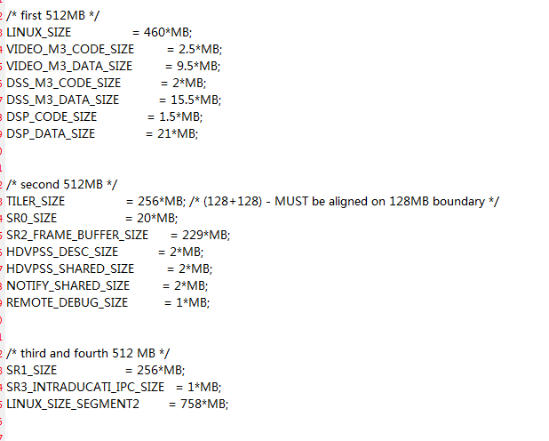

Hello Ti friends:
Here i meet a problem when i run load.sh. my config file is .
root@dvr:/opt/dvr_rdk/ti816x_2.8# ./load.sh
Attached to slave procId 2.
Loaded file ../firmware/dvr_rdk_fw_m3vpss.xem3 on slave procId 2.
Started slave procId 2.
After Ipc_loadcallback status [0x00000000]
After Ipc_startcallback status [0x097d2000]

it's pause forever.
who can help me? thanks for any help.

    Memory Map - 2GB DDR
    +-0x80000000-+   +-------------------+
             |       |   128 MB          | Linux
           |       |  337.5 MB         | (SR1) Bitstream buffer
             |       |                   | Cached on A8. Cached on M3, although access by DMAs
          |    |   1   MB          | (SR3)InterDucati IPC ListMP .Cached on M3
             +       |   2.5 MB          | Video M3 Code
           512 MB    +-------------------+
             +       |   10 MB           | Video M3 Data
             |       |   2   MB          | VPSS  M3 Code
             |       |   15.5 MB         | VPSS  M3 Data
             |       |   1.5 MB          | DSP Code
             v       |   14  MB          | DSP Data
    +-0xA0000000-+   +-------------------+
             ^       |   128 MB          | Tiled 8-bit region
             |       |   128 MB          | Tiled 16-bit region
             +       |  233 MB           | (SR2) Frame Buffer Region
           512 MB    |                   |  VPSS - Video M3 Frame Buf
             |       |  16  MB           | (SR0) Syslink MsgQ/IPC List MP
             |       |                   | Non-cached on M3
             |       |  2    MB          | VPSS M3 - VPDMA Descriptor
             |       |  2    MB          | VPSS M3 - FBDev Shared Memory
             |       |  2    MB          | Host - VPSS M3 Notify(For FBDev)
             v       |  1    MB          | Remote Debug Print
    +-0xC0000000-+   +-------------------+
           1024 MB   |  1024 MB          | Memory for Linux Kernel
             +       |                   | Available only in 2G-2G Split of linux kernel
             v       |                   |
    +-0xFFFFFFFF-+   +-------------------+

    DDR3_ADDR                  = 0x80000000;
    DDR3_SIZE                  = 2048*MB;
    OCMC0_ADDR                 = 0x40300000;
    OCMC1_ADDR                 = 0x40400000;
    OCMC0_RUN_ADDR             = 0x00300000;
    OCMC1_RUN_ADDR             = 0x00400000;
    OCMC_SIZE                  = 256*KB;
    L2_SRAM_ADDR               = 0x55024000;
    L2_SRAM_SIZE               = 128*KB;
    L2_SRAM_RUN_ADDR           = 0x20004000;
    DUCATI_WB_WA_ADDR          = 0x20000000;
    print("I will compile 2G bld\n");
    /* first 512MB */
    LINUX_SIZE                 = 460*MB;
    VIDEO_M3_CODE_SIZE         = 2.5*MB;
    VIDEO_M3_DATA_SIZE         = 9.5*MB;
    DSS_M3_CODE_SIZE           = 2*MB;
    DSS_M3_DATA_SIZE           = 15.5*MB;
    DSP_CODE_SIZE              = 1.5*MB;
    DSP_DATA_SIZE              = 21*MB;
    /* second 512MB */
    TILER_SIZE                 = 256*MB; /* (128+128) - MUST be aligned on 128MB boundary */
    SR0_SIZE                   = 20*MB;
    SR2_FRAME_BUFFER_SIZE      = 229*MB;
    HDVPSS_DESC_SIZE           = 2*MB;
    HDVPSS_SHARED_SIZE         = 2*MB;
    NOTIFY_SHARED_SIZE         = 2*MB;
    REMOTE_DEBUG_SIZE          = 1*MB;
    /* third and fourth 512 MB */
    SR1_SIZE                   = 256*MB;
    SR3_INTRADUCATI_IPC_SIZE   = 1*MB;
    LINUX_SIZE_SEGMENT2        = 758*MB;
    /* first 512MB */
    LINUX_ADDR                 = DDR3_ADDR;
    VIDEO_M3_CODE_ADDR         =  LINUX_ADDR   + LINUX_SIZE;
    VIDEO_M3_DATA_ADDR         = VIDEO_M3_CODE_ADDR         + VIDEO_M3_CODE_SIZE;
    DSS_M3_CODE_ADDR           = VIDEO_M3_DATA_ADDR         + VIDEO_M3_DATA_SIZE;
    DSS_M3_DATA_ADDR           = DSS_M3_CODE_ADDR           + DSS_M3_CODE_SIZE;
    DSP_CODE_ADDR              = DSS_M3_DATA_ADDR           + DSS_M3_DATA_SIZE;
    DSP_DATA_ADDR              = DSP_CODE_ADDR              + DSP_CODE_SIZE;
    /* second 512MB */
    TILER_ADDR                 =DSP_DATA_ADDR         + DSP_DATA_SIZE;
    SR0_ADDR                   = TILER_ADDR              + TILER_SIZE;
    SR2_FRAME_BUFFER_ADDR      =  SR0_ADDR + SR0_SIZE;
    HDVPSS_DESC_ADDR           = SR2_FRAME_BUFFER_ADDR      + SR2_FRAME_BUFFER_SIZE;
    HDVPSS_SHARED_ADDR         = HDVPSS_DESC_ADDR           + HDVPSS_DESC_SIZE;
    NOTIFY_SHARED_ADDR         = HDVPSS_SHARED_ADDR         + HDVPSS_SHARED_SIZE;
    REMOTE_DEBUG_ADDR          = NOTIFY_SHARED_ADDR         + NOTIFY_SHARED_SIZE;
    /* second 512MB */
    SR1_ADDR                   =  REMOTE_DEBUG_ADDR+REMOTE_DEBUG_SIZE;
    SR3_INTRADUCATI_IPC_ADDR   = SR1_ADDR                  + SR1_SIZE;
    Build.platformTable["ti.platforms.evmTI816X:core1"] =
        externalMemoryMap:
            ["DDR3_RAM", {
                comment: "DDR3_RAM",
                base: DDR3_ADDR,
                len:  DDR3_SIZE
            ["OCMC1_RAM", {
                comment: "OCMC1_RAM",
                base: OCMC1_ADDR,
                len:  OCMC_SIZE
        customMemoryMap:
            ["LINUX_MEM", {
                comment : "LINUX_MEM",
                base    : LINUX_ADDR,
                len     : LINUX_SIZE
            ["VIDEO_M3_CODE_MEM", {
                comment : "VIDEO_M3_CODE_MEM",
                base    : VIDEO_M3_CODE_ADDR,
                len     : VIDEO_M3_CODE_SIZE
            ["VIDEO_M3_DATA_MEM", {
                comment : "VIDEO_M3_DATA_MEM",
                base    : VIDEO_M3_DATA_ADDR,
                len     : VIDEO_M3_DATA_SIZE
            ["DSS_M3_CODE_MEM", {
                comment : "DSS_M3_CODE_MEM",
                base    : DSS_M3_CODE_ADDR,
                len     : DSS_M3_CODE_SIZE
            ["DDR3_M3", {
                comment : "DDR3_M3",
                base    : DSS_M3_DATA_ADDR,
                len     : DSS_M3_DATA_SIZE
            ["DSP_CODE_MEM", {
                comment : "DSP_CODE_MEM",
                base    : DSP_CODE_ADDR,
                len     : DSP_CODE_SIZE
            ["DSP_DATA_MEM", {
                comment : "DDR3_DSP",
                base    : DSP_DATA_ADDR,
                len     : DSP_DATA_SIZE
            ["TILER_MEM", {
                comment : "TILER_MEM",
                base    : TILER_ADDR,
                len     : TILER_SIZE
            ["SR0", {
                comment : "SR0",
                base    : SR0_ADDR,
                len     : SR0_SIZE
            ["SR2_FRAME_BUFFER_MEM", {
                comment : "SR2_FRAME_BUFFER_MEM",
                base    : SR2_FRAME_BUFFER_ADDR,
                len     : SR2_FRAME_BUFFER_SIZE
            ["HDVPSS_DESC_MEM", {
                comment : "HDVPSS_DESC_MEM",
                base    : HDVPSS_DESC_ADDR,
                len     : HDVPSS_DESC_SIZE
            ["HDVPSS_SHARED_MEM", {
                comment : "HDVPSS_SHARED_MEM",
                base    : HDVPSS_SHARED_ADDR,
                len     : HDVPSS_SHARED_SIZE
            ["HOST_VPSS_NOTIFYMEM", {
                comment : "HOST_VPSS_NOTIFYMEM",
                base    : NOTIFY_SHARED_ADDR,
                len     : NOTIFY_SHARED_SIZE
            ["REMOTE_DEBUG_MEM", {
                comment : "REMOTE_DEBUG_MEM",
                base    : REMOTE_DEBUG_ADDR,
                len     : REMOTE_DEBUG_SIZE
            ["SR1", {
                comment : "SR1",
                base    : SR1_ADDR,
                len     : SR1_SIZE
            ["SR3_INTRADUCATI_IPC", {
                comment : "SR3_INTRADUCATI_IPC",
                base    : SR3_INTRADUCATI_IPC_ADDR,
                len     : SR3_INTRADUCATI_IPC_SIZE
            ["L2_ROM", {
                comment: "L2_ROM",
                base: 0x00000000,
                len:  0x00004000
            ["OCMC1_RAM", {
                base: OCMC1_ADDR,
                len:  OCMC_SIZE
            ["OCMC1_RAM_MAPPED", {
                base: OCMC1_RUN_ADDR,
                len:  OCMC_SIZE
    Build.platformTable["ti.platforms.evmTI816X:core0"] =
        externalMemoryMap:
            ["DDR3_RAM", {
                base: DDR3_ADDR,
                len:  DDR3_SIZE
            ["OCMC0_RAM", {
                comment: "OCMC0_RAM",
                base: OCMC0_ADDR,
                len:  OCMC_SIZE
            ["L2_SRAM", {
                comment: "L2_SRAM",
                base: L2_SRAM_ADDR,
                len:  L2_SRAM_SIZE
            ["L2_SRAM_RUN", {
                comment: "L2_SRAM_RUN",
                base: L2_SRAM_RUN_ADDR,
                len:  L2_SRAM_SIZE
        customMemoryMap:
                   ["LINUX_MEM", {
                base    : LINUX_ADDR,
                len     : LINUX_SIZE
            ["DDR3_M3", {
            ["DSP_CODE_MEM", {
                len     : DSP_CODE_SIZE
            ["DSP_DATA_MEM", {
                len     : DSP_DATA_SIZE
            ["TILER_MEM", {
                base    : TILER_ADDR,
                len     : TILER_SIZE
            ["SR0", {
                comment : "SR0",
                base    : SR0_ADDR,
                len     : SR0_SIZE
            ["SR1", {
                comment : "SR1",
                base    : SR1_ADDR,
                len     : SR1_SIZE
            ["L2_SRAM", {
                comment: "L2_SRAM",
                base: L2_SRAM_ADDR,
                len:  L2_SRAM_SIZE
            ["L2_SRAM_RUN", {
                len:  L2_SRAM_SIZE
            ["L2_ROM", {
                comment: "L2_ROM",
                base: 0x00000000,
                len:  0x00004000
            ["OCMC0_RAM", {
                base: OCMC0_ADDR,
                len:  OCMC_SIZE
            ["OCMC0_RAM_MAPPED", {
                base: OCMC0_RUN_ADDR,
                len:  OCMC_SIZE
    Build.platformTable["ti.platforms.evmTI816X:plat"] =
        externalMemoryMap:
            ["DDR3_RAM", {
                base: DDR3_ADDR,
                len:  DDR3_SIZE
            ["OCMC0_RAM", {
                base: OCMC0_ADDR,
                len:  OCMC_SIZE
            ["OCMC1_RAM", {
                base: OCMC1_ADDR,
                len:  OCMC_SIZE
        customMemoryMap:
              ["LINUX_MEM", {
                base    : LINUX_ADDR,
                len     : LINUX_SIZE
            ["DDR3_M3", {
            ["DSP_CODE_MEM", {
                len     : DSP_CODE_SIZE
            ["DSP_DATA_MEM", {
                len     : DSP_DATA_SIZE
            ["TILER_MEM", {
                base    : TILER_ADDR,
                len     : TILER_SIZE
            ["SR0", {
                comment : "SR0",
                base    : SR0_ADDR,
                len     : SR0_SIZE
            ["SR1", {
                comment : "SR1",
                base    : SR1_ADDR,
                len     : SR1_SIZE
            ["OCMC0_RAM", {
                base: OCMC0_ADDR,
                len:  OCMC_SIZE
            ["OCMC1_RAM", {
                base: OCMC1_ADDR,
                len:  OCMC_SIZE
            ["DSP_L2_RAM", {
                comment: "DSP_L2_RAM",
                base: 0x10800000,
                len:  0x00020000
        l1PMode: "32k",
        l1DMode: "32k",
        l2Mode:  "128k"
    var addrFileGenerated = false;
    if (addrFileGenerated == false)
        xdc.loadCapsule("genaddrinfo.xs").GenAddrFile();
        addrFileGenerated = true;
