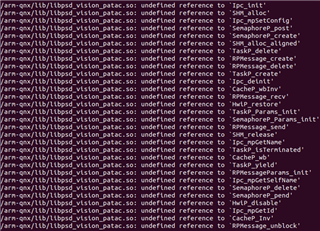

Background description: We are developing APA algorithms based on tda4vm and qnx710. The parking space detection algorithm is implemented by deep learning Caffe architecture and TIDL_OD demo in PSDKRA. I am compiling the parking space detection deep learning algorithm (similar to tidl_od demo in psdkra) into an executable program with qnx710. I link the following Ti library:
Question: However, errors are reported as follows: At present, I only know that the underlying Inter-Process Communication(IPC) libraries are missing. Those libraries should be compiled using the QNX compilation toolchain to compile the codes related to the underlying communication driver of TI PSDKRA into the corresponding libraries. I want to ask, which libraries are the following functions (such as SemaphoreP_delete,SHM_alloc_aligned,Ipc_mpGetId,Ipc_Init and so on) in and what are the libraries name?
Preliminary solution: IPC, RPM, task, hwip, semaphore, etc. have been found in ipc library and osal library. The paths are as follows:
I finally relied on ipc.aa72fg, ti.osal.aa72fg, sciclient.aa72fg, ti.csl.aa72fg, 30 symbols that cannot be found eventually become the following three symbols: “SHM_alloc”,”SHM_alloc_aligned”,”SHM_release”. I guess when linking TI SDK libraries (vision_apps / tiovx / imaging), many libraries that are not needed for deep learning may also be linked, resulting in the need of other lower level libraries, such as *.aa72fg, and then resulting in many symbols not found.

For #1, the sharedmemallocator symbols can be found at psdkqa/qnx/sharedmemallocator/usr/aarch64/a.le/libsharedmemallocator.a. The sources can be found at psdkqa/qnx/sharedmemallocator/usr/SharedMemAllocator.c
For #2, it will depend on the specifics of the demos itself. The imaging libraries may not be needed if the imaging algorithms are not used in the specific demos. However, each of the remaining libraries will be needed for the application.
