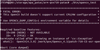

TDA4VM: The OpenCV library enabled neon runnig in tda4 qnx710 board and reporting an error: This opencv build doesn't support current CPU/HW configuration. NEON – NOT AVAILABLE
Part Number: TDA4VM
Hi, TI engineer
In Desay TDA4VM mass production board (not TDA4 EVM development board), which the board environment is qnx710/aarch64 (A72), I calls opencv4.3.0 libraries enabled NEON and compiled with qnx710 toolchain. But errors are reported as follows: This opencv build doesn't support current CPU/HW configuration. ID=100(NEON) – NOT AVAILABLE。 What are the possible reasons?
The tests I have done are as follows:
  1. I used the demo program to call the opencv library that enables neon running in the Qualcomm SA8155 QNX board, it’s OK and no error. But the same program will report an error in the tda4 QNX board.: This opencv build doesn't support current CPU/HW configuration. NEON – NOT AVAILABLE
  2. I recompiled the opencv source code with qnx710 and added the compilation option:-DENABLE_NEON=OFF, turn off neon actively. And then I use the same program to run in TDA44 qnx710 board. it’s OK and no error.
Analysis: The opencv Library enabled neon can run in Qualcomm sa8155 qnx board, but it cannot run in tda4 qnx board. However, The opencv Library not enabled neon can run in tda4 qnx board. Then we suspect that the running environment in tda4 board may cause the bug. Possible reasons are as follows:
  1. Maybe there is a problem with TDA4 SOC BSP?
  2. Or there is a problem with the customized qnx710 system running on the tda4 board. One of the two reasons does not enable neon, so the opencv library with neon cannot run on tda4 SOC.
I want to know what are the possible reasons?

    在TDA4 板子启动的时候,QNX BSP会读取ARM寄存器ID_AA64PFR0_EL1来确定NEON是否被底层平台支持。我们在板子中运行指令:pidin syspage=cpuinfo,log信息如下:
    J7EVM@QNX:/# pidin syspage=cpuinfo
    Header size=0x00000108, Total Size=0x00000950, #Cpu=2, Type=257
    Section:cpuinfo offset:0x00000340 size:0x00000040 elsize:0x00000020
    0) cpu:411fd080 flg:c0000c3a spd:2000 hwid:80000000 cache i/d:0/1 name:99
    history:0000000000000004
    1) cpu:411fd080 flg:c0000c3a spd:2000 hwid:80000001 cache i/d:0/1 name:99
    history:0000000000000003
    J7EVM@QNX:/#
    从log可知,我们手里的TDA4板子中的cpu和flag信息是:cpu:411fd080 flg:c0000c3a。KB的帖子说:支持NEON正确的flag应该是:cpu:411fd080 flg:c0000c7a,所以可以确定是我们板子中的qnx bsp没有设置正确,导致不支持NOEN。

            我已经在TDA4 QNX板子中验证通过了,只需要修改 ./src/hardware/startup/lib/aarch64/init_cpuinfo.c文件中的两个宏定义即可!重新编译BSP,将生成的.image文件推送到板子中,重启下板子,该TDA4板子就可以支持NEON加速了!
           非常感谢这两周的支持!此问题得到完美解决!THANKS
