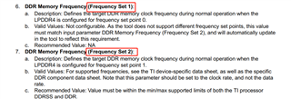

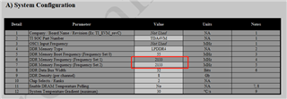

SPRACU8_Jacinto7_DDRSS_RegConfigTool,What are Frequency Set 1 and Frequency Set 2 described in the configuration document? If it is DDR, why are two frequencies Set?
LPDDR4允许内存设定2个频率设置点(FSP),可以百度一下标准。
https://www.jedec.org/news/pressreleases/jedec-releases-lpddr4-standard-low-power-memory-devices
但这个工具不支持FSP
1.1.2 Unsupported Features (version 0.6.0)
• LPDDR4 frequency set points
