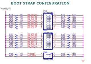

参考TMDSEVM6657原理图,看到bootmdoe上拉10K,下拉100欧,通过拔码进行可选:

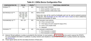

但手册上讲BOOTMODE[12:0]是IPD 1K,那上拉10K似乎是无效。
请问应如何理解,感谢!

数据手册第228页里有下面的说明。请问您现在用10k电阻不能上拉到高电平吗?
• A 20-kΩ resistor can be used to compliment the IPU/IPD on the device configuration pins while meeting the above criteria. Users should confirm this resistor value is correct for their specific application.
https://www.ti.com/lit/ds/symlink/tms320c6657.pdf
