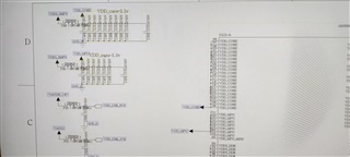

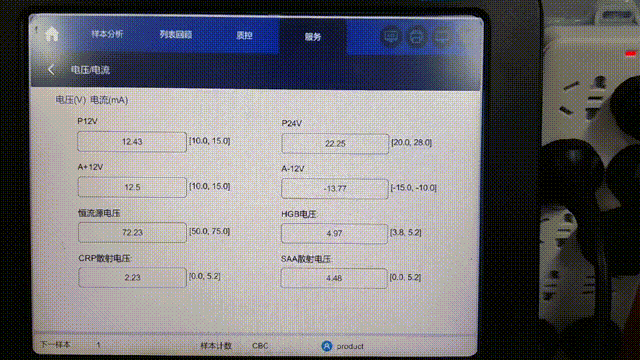

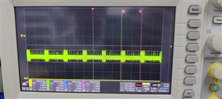

Qt应用程序200ms定时器刷新8个编辑框的值和样式,用示波器测量VDD_MPU引脚发现有间隔200ms的波动(电路去掉了10nf电容为了现象更明显),想知道这个波动的原因

I will not be able to help if the customer is not willing to explain what he is doing to cause the power supply variation. The schematic you inserted is too small for me to read, so I'm not able to comment on the circuit shown.

This looks like a power supply resonance created by the natural resonate frequency of the inductor F36 and the decoupling capacitors connected between F36 and the AM335x VDD_CORE supply pins. Ask them to short across F36 and see if the problem goes away.
Inserting a series inductor in the path of a high current transient load is not good design practice. This can only be done when there is enough de-coupling capacitance placed between the inductor and the load to ensure the voltage does not have any significant drop during the high current transients.
