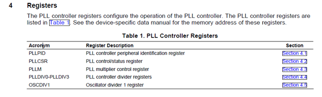

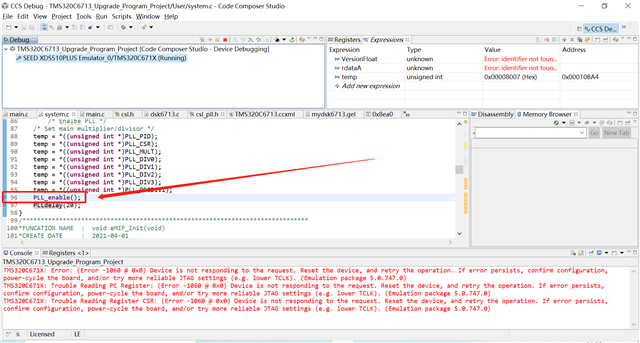

您好!我在上电后软件初始化PLL相关寄存器时程序复位,所有PLL寄存器: 都是可以正常读写,为了验证是不是我的参数设置错误导致复位,我将默认的PLL所有寄存器值读出,然后将寄存器的原始参数重新写进去,但是再最后使能PLL的时候程序跑飞并复位了,如下图:

  • 请问红框中的PLL_enable函数是在运行PLL_Init 运行后,再去调用的吗?
    如果在runtime重新去配置PLL的话,要先把PLL配置成bypass mode再去配置PLL寄存器。请看下面数据手册上的说明。
    The settings for the PLL multiplier and each of the dividers in the clock generation block may be reconfigured via software at run time. If either the input to the PLL changes due to D0, CLKMODE0, or CLKIN, or if the PLL multiplier is changed, then software must enter bypass first and stay in bypass until the PLL has had enough time to lock (see electrical specifications). For the programming procedure, see the TMS320C6000 DSP Software-Programmable Phase-Locked Loop (PLL) Controller Reference Guide (literature number SPRU233).
    https://www.ti.com/lit/ds/symlink/tms320c6713b.pdf
