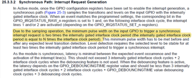

AM335x TRM中看到如下描述:
其中說明GPIO Interrupt需要的最小pulse寬度應該是 :
minimun pulse width = internally gated interface clock period x 2
internally gated interface clock period = interface clock period x N
請問一下上述的N值要去哪裡查詢或設定?感謝~

请参考 25.3.2.2 Clocks, Gating and Active Edge Definitions
www.ti.com.cn/.../spruh73q.pdf
应该是通过GPIO_CTRL 来配置的。
Table 25-20. GPIO_CTRL Register Field Descriptions
