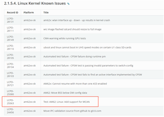

我看你们的AM62sdk的描述上写着add MCAN的使用;请问这个在哪里能找到例子;
另外M核的can请问现在有使用例程了吗,这颗CPU默认只有一路CAN,M核的CAN怎么分配给A核使用呢?

The challenge is that the current EVM does not have a CAN transceiver on it to experiment with. The silicon does support MCAN. There are CAN transceivers on the AM64x GP EVM.
