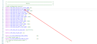

能否发一下您图2的代码?图片看不清,太小了。
stdFiltelem.sfec = 0x7;
stdFiltelem.sft = 0x0;
for(i = 0; i < (sizeod(gCanCmdParamConfig[mcanIdx])/sizeof(gCanCmdParamConfig[mcanIdx][0])); i++)
if(gCanCmdParamConfig[mcanIdx][i].can_id[0] == 0)
continue;
stdFiltelem.sfid2 = i;
stdFiltelem.sfid1 = gCanCmdParamConfig[mcanIdx][i].can_id[0];
MCAN_addStdMsgIDFilter(mcanAddr, i, &stdFiltelem);
程序对一个需要过滤的ID表,不断通过MCAN_addStdMsgIDFilter()添加过滤ID,然后一共是27个,但是只有前25个起作用了,后两个ID的报文收不到

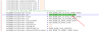

Can you confirm what is the value of msgRAMConfigParams.lse you are programing? This is 1 by default as APP_MCAN_EXT_ID_FILTER_NUM is defined as 1U in the SDK example.
这个APP_MCAN_EXT_ID_FILTER_NUM宏定义不是代表扩展CANID的吗,但是我需要过滤的是标准ID,应该是APP_MCAN_STD_ID_FILTER_NUM才对,我把它改成了64

Shine said:
Does APP_MCAN_EXT_ID_FILTER_NUM macro refer to CANID extension? Customer wanted to filter the standard ID, he set APP_MCAN_STD_ID_FILTER_NUM to 64, is it correct?
Yes, the APP_MCAN_EXT_ID_FILTER_NUM is for filters for extended ID, APP_MCAN_STD_ID_FILETER_NUM is correctly set to 64U.c It's maximum value can be 128U.
The configuration seems correct, is it possible to share the full application code from the customer so that I can try replicating this on my side on the EVM?
