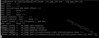

Part Number: TDA4VM
使用的sdk版本:ti-processor-sdk-rtos-j721e-evm-08_02_00_05
参考此链接:https://software-dl.ti.com/jacinto7/esd/processor-sdk-rtos-jacinto7/latest/exports/docs/vision_apps/docs/user_guide/group_apps_cv_demos_app_sfm.html#autotoc_md283 编译,并在TDA4上执行vx_app_sfm.out
报如下错误:
APP: Init ... !!!
MEM: Init ... !!!
MEM: Initialized DMA HEAP (fd=4) !!!
MEM: Init ... Done !!!
IPC: Init ... !!!
IPC: Init ... Done !!!
REMOTE_SERVICE: Init ... !!!
REMOTE_SERVICE: Init ... Done !!!
83926.612029 s: GTC Frequency = 200 MHz
APP: Init ... Done !!!
83926.618318 s: VX_ZONE_INIT:Enabled
83926.618335 s: VX_ZONE_ERROR:Enabled
83926.618343 s: VX_ZONE_WARNING:Enabled
83926.620718 s: VX_ZONE_INIT:[tivxInitLocal:130] Initialization Done !!!
83926.622654 s: VX_ZONE_INIT:[tivxHostInitLocal:86] Initialization Done for HOST !!!
83926.642181 s: VX_ZONE_ERROR:[ownContextSendCmd:815] Command ack message returned failure cmd_status: -7
83926.642204 s: VX_ZONE_ERROR:[ownContextSendCmd:851] tivxEventWait() failed.
83926.642235 s: VX_ZONE_ERROR:[ownNodeKernelInit:538] Target kernel, TIVX_CMD_NODE_CREATE failed for node node_163
83926.642254 s: VX_ZONE_ERROR:[ownNodeKernelInit:539] Please be sure the target callbacks have been registered for this core
83926.642271 s: VX_ZONE_ERROR:[ownNodeKernelInit:540] If the target callbacks have been registered, please ensure no errors are occurring within the create callback of this kernel
83926.642289 s: VX_ZONE_ERROR:[ownGraphNodeKernelInit:583] kernel init for node 0, kernel com.ti.hwa.display ... failed !!!
83926.642310 s: VX_ZONE_ERROR:[vxVerifyGraph:2055] Node kernel init failed
83926.642348 s: VX_ZONE_ERROR:[vxVerifyGraph:2109] Graph verify failed
GRPX: ERROR: Unable to verify graph for graphics !!!
83926.681172 s: VX_ZONE_ERROR:[ownContextSendCmd:815] Command ack message returned failure cmd_status: -7
83926.681187 s: VX_ZONE_ERROR:[ownContextSendCmd:851] tivxEventWait() failed.
83926.681197 s: VX_ZONE_ERROR:[ownNodeKernelInit:538] Target kernel, TIVX_CMD_NODE_CREATE failed for node DisplayNode
83926.681206 s: VX_ZONE_ERROR:[ownNodeKernelInit:539] Please be sure the target callbacks have been registered for this core
83926.681214 s: VX_ZONE_ERROR:[ownNodeKernelInit:540] If the target callbacks have been registered, please ensure no errors are occurring within the create callback of this kernel
83926.681495 s: VX_ZONE_ERROR:[ownGraphNodeKernelInit:583] kernel init for node 5, kernel com.ti.hwa.display ... failed !!!
83926.681511 s: VX_ZONE_ERROR:[vxVerifyGraph:2055] Node kernel init failed
83926.681519 s: VX_ZONE_ERROR:[vxVerifyGraph:2109] Graph verify failed
MSC: Node send command failed!
83926.784290 s: VX_ZONE_INIT:[tivxHostDeInitLocal:100] De-Initialization Done for HOST !!!
83926.788652 s: VX_ZONE_INIT:[tivxDeInitLocal:193] De-Initialization Done !!!
APP: Deinit ... !!!
REMOTE_SERVICE: Deinit ... !!!
REMOTE_SERVICE: Deinit ... Done !!!
IPC: Deinit ... !!!
IPC: DeInit ... Done !!!
MEM: Deinit ... !!!
MEM: Alloc's: 62 alloc's of 34740448 bytes
MEM: Free's : 62 free's of 34740448 bytes
MEM: Open's : 0 allocs of 0 bytes
MEM: Deinit ... Done !!!
APP: Deinit ... Done !!!
这个问题如何解决呢?

  • 请提供以下信息以便于分析问题:
    1. 从 ti.com 安装原始 RTOS SDK 并运行 sfm Demo时,是否观察到这种情况?还是在 SDK 中进行了任何更改?
    2. 在附加的日志中看到root@tda4vm-sk。 这是SK板还是EVM?
    3. 如果是 EVM,您能否在应用程序之前运行“source ./vision_apps_init.sh”并与我提供相同的日志?
    4. 显示器连接了吗?
    5. SDK中的app_sfm.cfg文件有变化吗?
    6. 您是否已将 test_data 提取到 SD 卡?
    7. sfm Demo中是否还有任何修改?
    请注意:我们在 TDA4VM-EVM 上的 SDK 8.2 上测试了这个demo,它工作正常的。
  • 感谢您的答复,麻烦帮我把以下回复同步到对应英文链接:https://e2e.ti.com/support/processors-group/processors/f/processors-forum/1135060/tda4vm-execute-sfm-structure-from-motion-demo-reporting-error
    1. 原始8.2的SDK,没有做修改,就是这样的
    2. 是tda4vm-sk,SK板,请问SK板和EVM板的差异是啥?
    4. 使用HDMI线连接板子和显示器
    5. app_sfm.cfg中修改了:input_file_path,output_file_path,input_cam_proj_file,这三个路径替换成我自己的路径了
    6. test_data 放在SD卡上了
    7. 没有修改 sfm Demo
    3. 执行./vx_app_sfm.out --cfg app_sfm.cfg日志就是上面发的. 执行 vision_apps_init.sh日志如下:

  • 是tda4vm-sk,SK板,请问SK板和EVM板的差异是啥?
    这是EdgeAI SDK vs Processor SDK文档:
    https://software-dl.ti.com/jacinto7/esd/processor-sdk-linux-sk-tda4vm/08_04_00/exports/docs/faq.html
    这里提到“SDK 也不兼容。EdgeAI SDK 仅适用于 TDA4VM SK,Processor SDK 仅适用于 J721E EVM”
    您是否可以在 TDA4VM-EVM 上测试此demo?
    如果不可以,请在 sk board 上查找以下用于构建 psdk rtos 的文档。
    https://software-dl.ti.com/jacinto7/esd/processor-sdk-linux-sk-tda4vm/08_04_00/exports/docs/development_flow.html
    请按照上述文档中的“Building the RTOS SDK from source”步骤进行操作。
    在附加的日志中,我没有看到诸如“DSS:Init ... !!!”之类的日志 , "DSS: 显示类型是 HDMI !!!" 来自文件 vision_apps/utils/dss/src/app_dss_defaults.c 这意味着 DSS 显示组件尚未初始化。
    使用上述程序构建后,能否确保在 vision_apps_init.sh 日志中的 [MCU2_0] 中获得上述日志?
