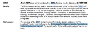

关于TDA4VM的errata文件中的i2307中提到的device specific datasheet, section "Applications,Implementation, and Layout".文件链接有么,,如下截图蓝色部分,谢谢
请参考数据手册的9.3.2 OSPI and QSPI Board Design and Layout Guidelines
https://www.ti.com/lit/ds/symlink/tda4vm.pdf
