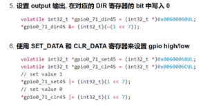

我们想在R 核(MCU2_0) 上面控制MAIN_GPIO0_71 引脚,通过下面的程序,但是没有什么效果,可以帮忙看一下吗? 谢谢

抱歉回复晚了,下面是e2e工程师的回复。
Please refer to the discussion e2e.ti.com/.../4092290 This should answer your queries. Please let me know if you have any further questions.
