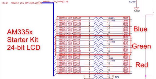

Hi Expert,
請問LCD Errata是指下圖的24 bit LCD RGB接線一定要參照下圖去接嗎?
| AM335x Schematic Checklist (Rev. A) |
2.9 LCD
Figure 1. AM335x Starter Kit, 24-Bit LCD
Thanks

是的,RGB888和RGB565的线序不一样,这在勘误表里有说明。
Figure 2. RGB888 Mode LCD Controller Output Pin Mapping (LCD_DATA[23:0])
https://www.ti.com/lit/er/sprz360i/sprz360i.pdf
