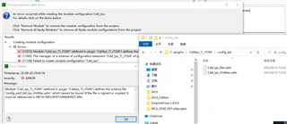

在添加Cdd_IPC模块时,无法成功添加,EB报如下错误

I've taken the configuration that comes along with this SDK version (MCUSW_01_05_00_01_CONFIG), created a fresh copy of it into the plugins folder of the EB Tresos installation and generated the code with no issues.
Firstly, has the customer modified the configuration at all, or is it the default configuration?
One thing to note, if you update the configuration Plugins in the EB/tresos/plugins folder, you will need to make sure that Tresos is not currently running, and once you have copied over the new configurations, you can open it again.
