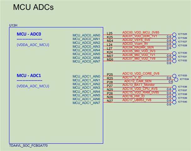

Hi,
我们是 TDA4VL 型号(提交时的型号选择只有 VM,所以填写的 VM),开发过程中有需要读取 adc 值一步。
能否不用 mcu 或者上层系统帮忙,在驱动中就获取到某些 adc 的读值呢?比如配置好设备树,用专用封装好的函数等方法。
期待并感谢您的回复!

请看我们工程师的回复。
Currently the MCU_ADC0/1 are not enabled in TDA4VL/J721S2 in the SDK.
Looking at the J721s2/TDA4VL device descriptions:
https://software-dl.ti.com/tisci/esd/latest/5_soc_doc/j721s2/devices.html
The device numbers for MCU_ADC0/1 are the same as compared with J721e.
So We can add the DT nodes to J721s2 as well.
Something like: mcu_adc_j721s2_dt.patch
Then follow the ADC documentation: https://software-dl.ti.com/jacinto7/esd/processor-sdk-linux-jacinto7/08_04_00_11/exports/docs/linux/Foundational_Components/Kernel/Kernel_Drivers/ADC.html
Note: I have not tried this on the TDA4VL hardware.
