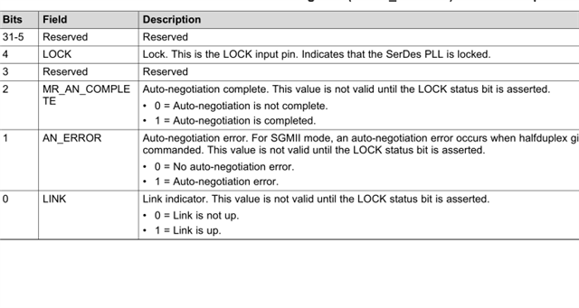

我的单板是c6678, 第二个网口,网口的serdes 的参考时钟是250M
所以我修改了:pa_ss_init.c 的serdes_init 函数
static int serdes_init(void)
#ifdef CONFIG_ARCH_BOARD_EVM6670
dscr_set_reg(DSCR_SGMII_SERDES_CFGPLL, 0x00000051);
#else
// dscr_set_reg(DSCR_SGMII_SERDES_CFGPLL, 0x00000041);
#endif
_c6x_delay(2000);
#ifdef CONFIG_ARCH_BOARD_EVMTCI6616
dscr_set_reg(DSCR_SGMII_SERDES_CFGRX0, 0x00460411);
dscr_set_reg(DSCR_SGMII_SERDES_CFGRX1, 0x00460411);
dscr_set_reg(DSCR_SGMII_SERDES_CFGTX0, 0x00011F91);
dscr_set_reg(DSCR_SGMII_SERDES_CFGTX1, 0x00011F91);
#else
// dscr_set_reg(DSCR_SGMII_SERDES_CFGRX0, 0x00700621);
// dscr_set_reg(DSCR_SGMII_SERDES_CFGRX1, 0x00700621);
// dscr_set_reg(DSCR_SGMII_SERDES_CFGTX0, 0x000108A1);
// dscr_set_reg(DSCR_SGMII_SERDES_CFGTX1, 0x000108A1);
dscr_set_reg(DSCR_SGMII_SERDES_CFGRX0, 0x00448621);
dscr_set_reg(DSCR_SGMII_SERDES_CFGRX1, 0x00448621);
dscr_set_reg(DSCR_SGMII_SERDES_CFGTX0, 0x00010FA1);
dscr_set_reg(DSCR_SGMII_SERDES_CFGTX1, 0x00010FA1);
#endif
_c6x_delay(2000);
return 0;
但是网络还是不通
