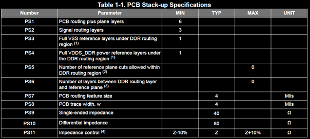

想跟您請教, AM6412 LPDDR4 layout design這部分, guidelines標示impedance DP80ohm, Single end40ohm,
請問公版layout也是照這樣設計嗎?
