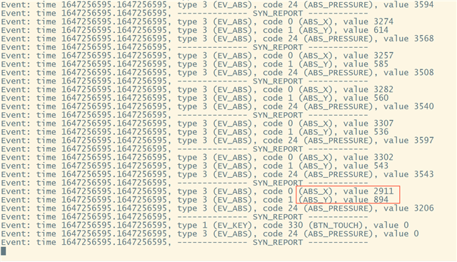

Part Number: AM625
SDK版本08.03.00.19
如下图,在使用电阻触摸时,经常出现触点偏移到别的位置的情况,通过evtest发现,每次出现偏移,最后一个点上报的数据都出现很大的偏差,请问这个怎么解决

What hardware is the customer using? (i.e., a TI EVM? Which one? How is the touchscreen getting connected to the board?)
What software changes has the customer made to enable the touchscreen?
