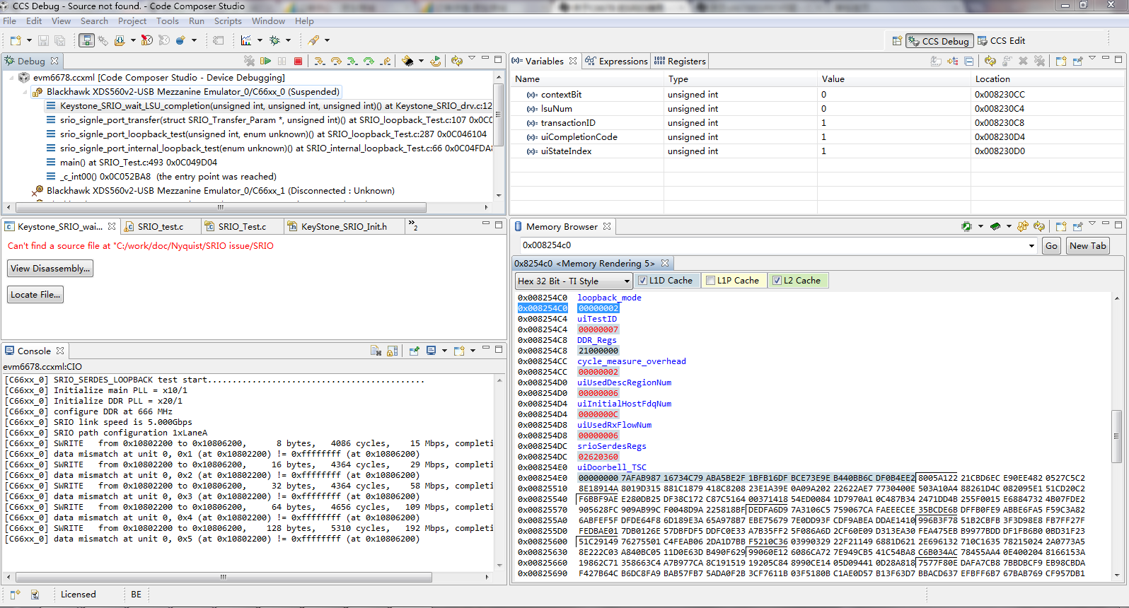

    4,loopback_mode= SRIO_SERDES_LOOPBACK ;时在EVM上出错:
    [C66xx_0] SRIO_SERDES_LOOPBACK test start............................................
    [C66xx_0] Initialize main PLL = x10/1
    [C66xx_0] Initialize DDR PLL = x20/1
    [C66xx_0] configure DDR at 666 MHz
    [C66xx_0] SRIO link speed is 5.000Gbps
    [C66xx_0] SRIO path configuration 1xLaneA
    [C66xx_0] SWRITE   from 0x10802200 to 0x10806200,      8 bytes,   4086 cycles,    15 Mbps, completion code = 0
    [C66xx_0] SWRITE   from 0x10802200 to 0x10806200,     16 bytes,   4372 cycles,    29 Mbps, completion code = 0
    [C66xx_0] data mismatch at unit 0, 0x2 (at 0x10802200) != 0xffffffff (at 0x10806200)
    [C66xx_0] SWRITE   from 0x10802200 to 0x10806200,     32 bytes,   4364 cycles,    58 Mbps, completion code = 0
    [C66xx_0] data mismatch at unit 0, 0x3 (at 0x10802200) != 0xffffffff (at 0x10806200)
    [C66xx_0] SWRITE   from 0x10802200 to 0x10806200,     64 bytes,   4654 cycles,   110 Mbps, completion code = 0
    [C66xx_0] data mismatch at unit 0, 0x4 (at 0x10802200) != 0xffffffff (at 0x10806200)
    [C66xx_0] SWRITE   from 0x10802200 to 0x10806200,    128 bytes,   5310 cycles,   192 Mbps, completion code = 0
    [C66xx_0] data mismatch at unit 0, 0x5 (at 0x10802200) != 0xffffffff (at 0x10806200)
    [C66xx_0] SWRITE   from 0x10802200 to 0x10806200,    256 bytes,   6332 cycles,   323 Mbps, completion code = 0
    [C66xx_0] data mismatch at unit 0, 0x6 (at 0x10802200) != 0xffffffff (at 0x10806200)
    5,怀疑是修改程序出错,于是加载论坛中的.out,修改008254c0   loopback_mode =2(SRIO_SERDES_LOOPBACK ),运行,结果一样,如下
    请问有可能是哪里设置错误了?
