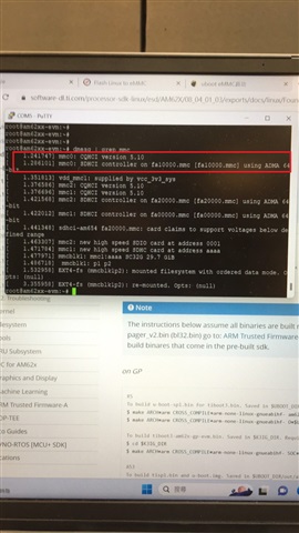

请问是在自制板上测试的吗?使用的是哪个版本的SDK?
请参考uboot中dts中的配置。
ti-u-boot-08.06.00.007\arch\arm\dts\k3-am62-main.dtsi
k3-am62x-sk-common.dtsi
截图中的输出框的log放大看看。
mmc list/mmc info指令查查看能否查到信息。
Hi Nancy
附件為log
謝謝
Daniel

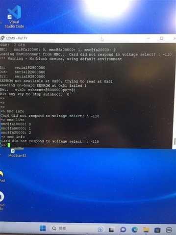

mmc list是能够查到设备信息的,如果已经进行分区,能否查到分区信息?请再次贴出以下指令的输出log:
=>mmc dev 0
=>mmc info
=>mmc part

並沒有進行分區,LOG如附件
謝謝
Daniel
=> mmc list mmc@fa10000: 0 mmc@fa00000: 1 mmc@fa20000: 2 => mmc dev 0 Card did not respond to voltage select! : -110 => mmc info Card did not respond to voltage select! : -110 => mmc part Card did not respond to voltage select! : -110 =>

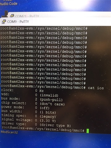

Dear Nancy ,
I found the problem is "cmd1 with the reply always showing bit 31 of OCR as busy (0)" ,it detected the power failed .
The eMMC part is connected to 3V3 for VCC and VCCQ at 1V8 with power rails measured at 3.32 and 1.81V . Does have the power sequence for 3.32 and 1.81V ? or PMIC problem ?
Jack Wang
我需要确认一下。
上电时序要符合手册7.11.2.2 Power Supply Sequencing的要求。
SK-am62的原理图中也提到了上电时序的要求,都可参考。
