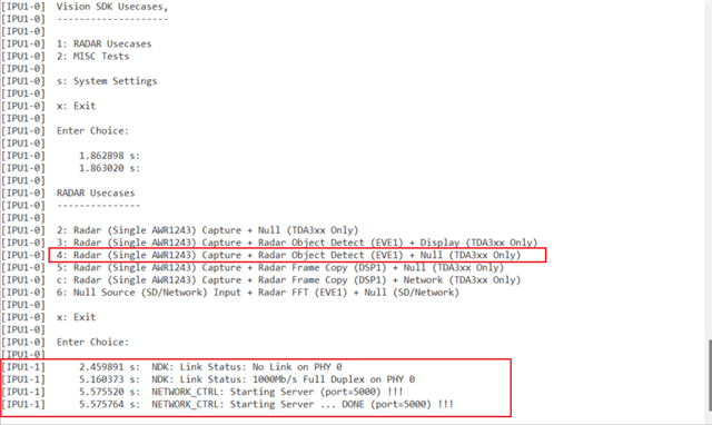

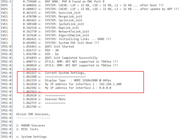

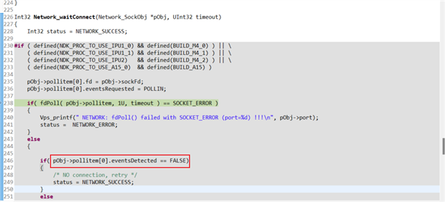

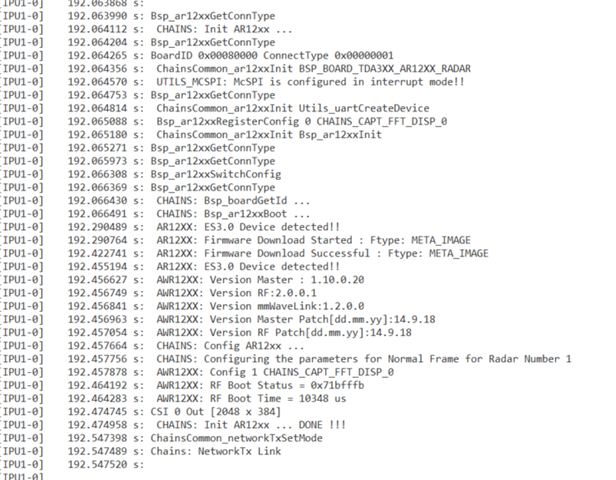

TDA3XEVM: 根据TDA3EVM原理图自制板,跑例程4: Radar (Single AWR1243) Capture + Radar Object Detect (EVE1) + Null (TDA3xx Only),ping 192.168.1.200无法访问目标主机,紧急求助
Part Number: TDA3XEVM
Other Parts Discussed in Thread: AWR1243
下面是串口输出的log
我选择的usecase是 Radar (Single AWR1243) Capture + Radar Object Detect (EVE1) + Null (TDA3xx Only),根据输出的信息好像程序显示网络服务正常工作,但是用wireshark抓包没有任何信息,是程序配置的原因还是硬件的原因,下面是运行usecase 4 输出的初始化信息

[IPU1-1]    361.155005 s:  IPC_IN_0   : Create in progress !!!
[IPU1-1]    361.155889 s:  IPC_IN_0   : Create Done !!!
[IPU1-1]    361.156621 s:  NETWORK_TX: NETWORK_TX: Server listening (port=29172) !!!
[IPU1-1]    361.157902 s:  SYSTEM: SW Message Box Msg Pool, Free Msg Count = 1023
[IPU1-1]    361.158024 s:  SYSTEM: Heap = LOCAL_DDR            @ 0x00000000, Total size = 262144 B (256 KB), Free size = 246224 B (240 KB)
