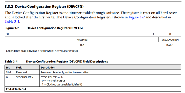

    SYSCLKOUT是有输出的吗?可以先做一下回环测试看看。

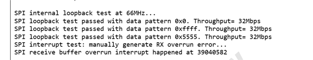

    我的回环测试中,控制台输出信号如下:
    SPI internal loopback test at 66MHz...
    KeyStone_SPI_TxRx_debug : gpSPI_regs->SPIDAT1 = 0x13020000
    KeyStone_SPI_TxRx_debug : gpSPI_regs->SPIBUF&0xFFFF= 0x0
    KeyStone_SPI_TxRx_debug : length= 0x10
    TSCL=2693678. startTSC= 2653912. cycles=39754
    SPI loopback test ok at word 0: TX =0x0, RX= 0x0
    SPI loopback test ok at word 1: TX =0x0, RX= 0x0
    SPI loopback test ok at word 2: TX =0x0, RX= 0x0
    SPI loopback test ok at word 3: TX =0x0, RX= 0x0
    SPI loopback test ok at word 4: TX =0x0, RX= 0x0
    SPI loopback test ok at word 5: TX =0x0, RX= 0x0
    SPI loopback test ok at word 6: TX =0x0, RX= 0x0
    SPI loopback test ok at word 7: TX =0x0, RX= 0x0
    TSCL=2792568. startTSC= 2653912. cycles=39754
    SPI_LOOP_TEST_BUF_SIZE=8. gDSP_Core_Speed_Hz= 1000000000. throughput=39754
    SPI loopback test passed with data pattern 0x0. Throughput= 3Mbps
    KeyStone_SPI_TxRx_debug : gpSPI_regs->SPIDAT1 = 0x130200ff
    KeyStone_SPI_TxRx_debug : gpSPI_regs->SPIBUF&0xFFFF= 0xff
    TSCL=2870477. startTSC= 2830670. cycles=39795
    SPI loopback test ok at word 0: TX =0xffff, RX= 0xffff
    SPI loopback test ok at word 1: TX =0xffff, RX= 0xffff
    SPI loopback test ok at word 2: TX =0xffff, RX= 0xffff
    SPI loopback test ok at word 3: TX =0xffff, RX= 0xffff
    SPI loopback test ok at word 4: TX =0xffff, RX= 0xffff
    SPI loopback test ok at word 5: TX =0xffff, RX= 0xffff
    SPI loopback test ok at word 6: TX =0xffff, RX= 0xffff
    SPI loopback test ok at word 7: TX =0xffff, RX= 0xffff
    TSCL=2973449. startTSC= 2830670. cycles=39795
    SPI_LOOP_TEST_BUF_SIZE=8. gDSP_Core_Speed_Hz= 1000000000. throughput=39795
    SPI loopback test passed with data pattern 0xffff. Throughput= 3Mbps
    KeyStone_SPI_TxRx_debug : gpSPI_regs->SPIDAT1 = 0x13020055
    KeyStone_SPI_TxRx_debug : gpSPI_regs->SPIBUF&0xFFFF= 0x55
    TSCL=3051575. startTSC= 3011769. cycles=39794
    SPI loopback test ok at word 0: TX =0x5555, RX= 0x5555
    SPI loopback test ok at word 1: TX =0x5555, RX= 0x5555
    SPI loopback test ok at word 2: TX =0x5555, RX= 0x5555
    SPI loopback test ok at word 3: TX =0x5555, RX= 0x5555
    SPI loopback test ok at word 4: TX =0x5555, RX= 0x5555
    SPI loopback test ok at word 5: TX =0x5555, RX= 0x5555
    SPI loopback test ok at word 6: TX =0x5555, RX= 0x5555
    SPI loopback test ok at word 7: TX =0x5555, RX= 0x5555
    TSCL=3154547. startTSC= 3011769. cycles=39794
    SPI_LOOP_TEST_BUF_SIZE=8. gDSP_Core_Speed_Hz= 1000000000. throughput=39794
    SPI loopback test passed with data pattern 0x5555. Throughput= 3Mbps
    2.2我咨询下:clockSpeedKHz —>66000,表示SPI始终频率设置了66M,为何计算的传输速率只有3Mbps?
    另在别实验中,进行NOR FLASH来固化程序测试时序,其中clockSpeedKHz —>48M,测量中发现SPI的时钟周期1.0160us,频率计算在984251hz=984khz这样正常?什么原因?

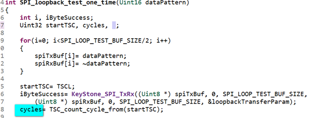

    回环测试中传输速率计算代码如下:
    int SPI_loopback_test_one_time(Uint16 dataPattern)
    int i, iByteSuccess;
    Uint32 startTSC, cycles, throughput;
    for(i=0; i<SPI_LOOP_TEST_BUF_SIZE/2; i++)
    spiTxBuf[i]= dataPattern;
    spiRxBuf[i]= ~dataPattern;
    startTSC= TSCL;
    iByteSuccess= KeyStone_SPI_TxRx((Uint8 *) spiTxBuf, 0, SPI_LOOP_TEST_BUF_SIZE,
    (Uint8 *) spiRxBuf, 0, SPI_LOOP_TEST_BUF_SIZE, &loopbackTransferParam);
    cycles= TSC_count_cycle_from(startTSC);
    printf("TSCL=%d. startTSC= %d. cycles=%d\n",TSCL, startTSC, cycles);
    if(iByteSuccess!=SPI_LOOP_TEST_BUF_SIZE)
    printf("SPI loopback test failed. TX %d bytes, RX %d bytes!\n",
    SPI_LOOP_TEST_BUF_SIZE, iByteSuccess);
    return iByteSuccess;
    if(spiTxBuf[i]!=spiRxBuf[i])
    printf("SPI loopback test failed at word %d: TX 0x%x, RX 0x%x\n",
    i, spiTxBuf[i], spiRxBuf[i]);
    return i;
    printf("SPI loopback test ok at word %d: TX =0x%x, RX= 0x%x\n",
    throughput = (unsigned long long)SPI_LOOP_TEST_BUF_SIZE*8*gDSP_Core_Speed_Hz/
    ((unsigned long long)cycles*1000000);
    printf("SPI_LOOP_TEST_BUF_SIZE=%d. gDSP_Core_Speed_Hz= %d. throughput=%d\n",
    SPI_LOOP_TEST_BUF_SIZE/2, gDSP_Core_Speed_Hz);
    printf("SPI loopback test passed with data pattern 0x%x. Throughput= %dMbps\n",
    dataPattern, throughput);
    return SPI_LOOP_TEST_BUF_SIZE;
  • C6678处理器的sysclk7 可以通过什么方法测试吗?
    输出到SYSCLKOUT看一下。需要使能DEVCFG。
    这是在evm板上测出来的数据。

    因本人刚接触DSP,技术方面比较白。查下说明书,DEVCFG是CSL_BOOT_CFG_REGS (0x02620000)结构的成员。
    我也没有在主函数找到 CSL_BOOT_CFG_REGS .DEVCFG的控制代码,请问Main函数中那个函数是控制DEVCFG的吗?
    这边使用7242.K1_STK_v1.1的SPI代码,控制台输出:
    SPI loopback test passed with data pattern 0x0. Throughput= 28Mbps
    SPI loopback test passed with data pattern 0xffff. Throughput= 28Mbps
    SPI loopback test passed with data pattern 0x5555. Throughput=28Mbps
    SPI interrupt test: manually generate RX overrun error...
    SPI test complete at 1003485114615 cycle

  • 因本人刚接触DSP,技术方面比较白。查下说明书,DEVCFG是CSL_BOOT_CFG_REGS (0x02620000)结构的成员。
    这个问题自己应该知道怎么解决了,不用回答了。

  • 你好。咨询下,在我们的开发板上我跑相同SPI回环程序,如果吞吐率只有28Mbps,是程序增加了一些LOG输出的原因,还是硬件损耗的原因吗?
  • 是程序增加了一些LOG输出的原因
    看您log加在哪里,如果影响cycle计数的话,也是会影响最终计算的吞吐率的。
  • 是的 ,LOG和数据大小都会影响吞吐率。
