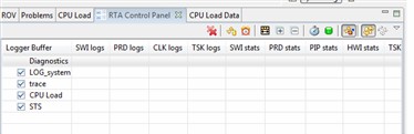

如何使能RTA
我想使用RTA,但是没有成功,请指导一下是怎么回事,谢谢!Platform: C64+ DSP
CCS 4.2.4
BIOS 5.41
Emulator:  我用的是闻亭的560v2仿真器(without system trace)
I followed the instruction in:
processors.wiki.ti.com/.../BIOS_Real-time_Analysis_(RTA)_troubleshooting
http://processors.wiki.ti.com/index.php/BIOS_5_Real-Time_Analysis_%28RTA%29_in_CCSv4
Here are the last part of my TCF:
bios.GBL.ENABLEINST = 1;
bios.GBL.ENABLEALLTRC = 1;
bios.RTDX.ENABLERTDX = 1;
bios.HST.HOSTLINKTYPE = "RTDX";
bios.enableRealTimeAnalysis(prog);
bios.enableRtdx(prog);
prog.module("GBL").ENABLEALLTRC = true;
我配置好了,运行只看到附件的图,无论是运行过程中,还是运行结束,都没有看到有任何的信息出来,请问有什么办法?谢谢!
