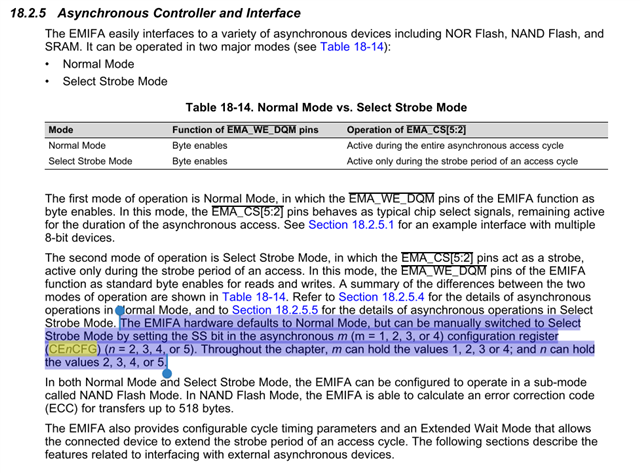

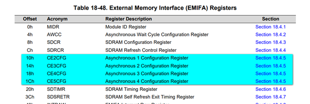

The EMIFA hardware defaults to Normal Mode, but can be manually switched to Select
Strobe Mode by setting the SS bit in the asynchronous m (m = 1, 2, 3, or 4) configuration register
(CEnCFG) (n = 2, 3, 4, or 5). Throughout the chapter, m can hold the values 1, 2, 3 or 4; and n can hold
the values 2, 3, 4, or 5.
我在查阅数据手册的时候,看到了手册内有这么一段话,但是我不理解这个m是什么意思,方便解释一下吗?
具体文件页面内容见下图.
