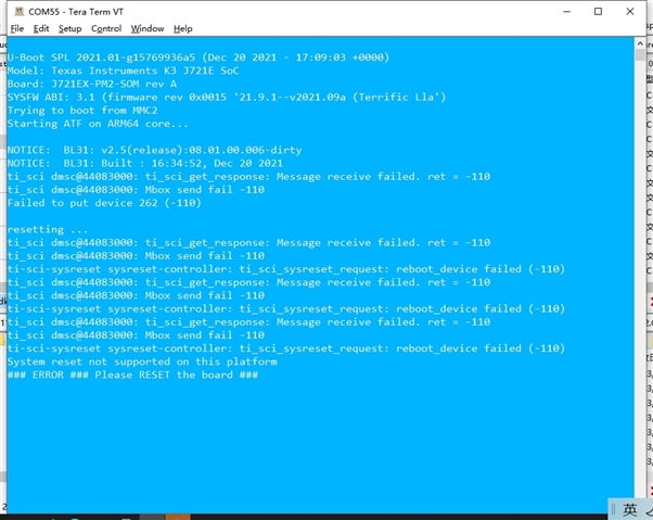

目前我在muc3_0上做了一些开发,现在我计划将mcu3_0的代码移植到mcu1_0上,且已经在CCS上调试成功了,现在尝试将mcu1_0用SPL启动。spl启动中,存储介质为emmc。

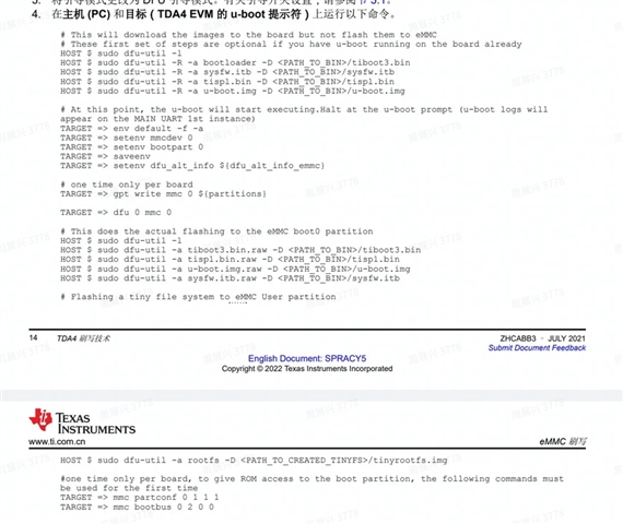

在调试过程中发现,mcu1_0的代码是通过a72的bootloader启动的(tispl.bin),所以我在重新编译了u-boot,并将a72目录下的tispl.bin重新烧录到emmc中:

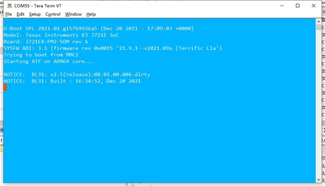

但是在重新启动时发现了如下错误:程序卡在此处,不再进行:
后来我尝试使用prebuild目录下的mcu1_0的代码重新生成tispl.bin,然后重新启动,但是任然出现了一些错误、无法启动:

您可以看下工程师的最新答复:
The MCU1_0 is responsible for device management. Once it finishes executing SPL it loads the device manager binary on to itself. The prebuilt binary should have worked ideally. Can the customer share the steps on how they are creating the tispl.bin.
