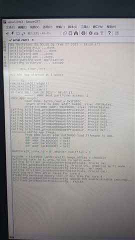

目前bootload开发的方案,sbl加载bootload,再由bootload加载app。三者都是运行在Mcu1_0上,bootload加载到DDR及部分的OCMC。当bootload将app从EMMC加载到DDR后,MCU1_0需要从锁步模式退出到分离模式,此时会提示操作失败,请问有没有解决办法,谢谢。

There are 3 components: SBL, BootLoader and App and three of these components run on MCU1_0.
You want to boot SBL and Bootloader in Lockstep mode but when loading app on mcu1_0 you want to load in split mode?
What is the intent of using split mode for the app? Are you loading different firmware on mcu1_0 and mcu1_1.
Also, can you please share the steps you are following to switch between split/lockstep mode?
