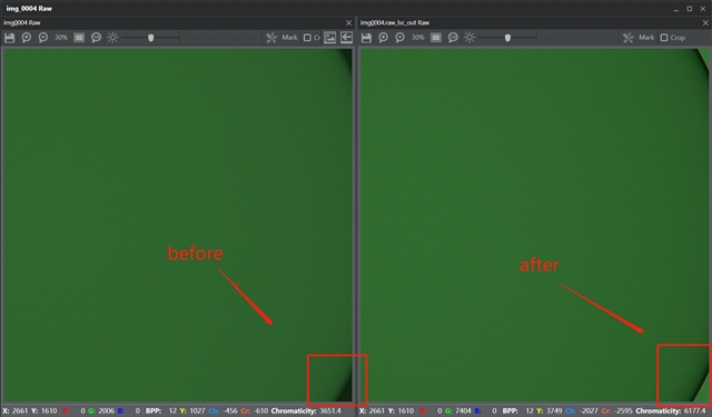

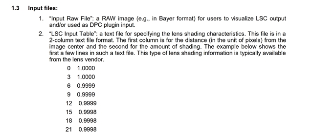

Dear TI experts
When I asked the module manufacturer for the lut table file needed for LSC calibration, they didn't know what I needed. How else can I describe this file, or is there any other way for me to skip this correction shading
