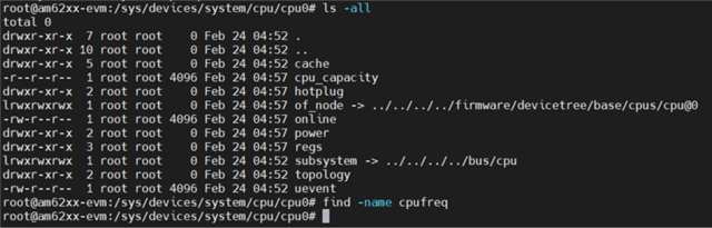

你好:
想在linux中查看cpu的频率,在base-image安装的linux中并没有k3conf工具,如何让获取安装?
是否可以通过安装cpufrequtils这种通用工具查询cpu频率
https://git.ti.com/cgit/k3conf/k3conf/tree/README.md
可以用$ cat /sys/devices/system/cpu/cpu0/cpufreq/scaling_cur_freq查看CPU频率。
https://software-dl.ti.com/processor-sdk-linux/esd/AM62X/08_06_00_42/exports/docs/linux/Foundational_Components/Kernel/Kernel_Drivers/Power_Management/pm_dvfs.html
也有。
By default, cpufreq, the cpufreq driver, and all of the standard governors are enabled with the ondemand governor selected as the default governor.
https://software-dl.ti.com/processor-sdk-linux-rt/esd/AM62X/09_00_00_03/exports/docs/linux/Foundational_Components/Kernel/Kernel_Drivers/Power_Management/pm_dfs.html
通过SD卡刷入ti-default-image和base-image,都没有看到有cpufreq
请问是系统没有起来吗?
