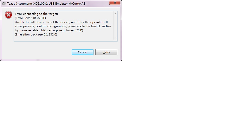

   我现在把8168 evm上的内存改为了2G。在串口终端上什么也打印不出。用CCS运行的话。打印出
CortexA8: Error connecting to the target: (Error -2062 @ 0x1FE) Unable to halt device. Reset the device, and retry the operation. If error persists, confirm configuration, power-cycle the board, and/or try more reliable JTAG settings (e.g. lower TCLK). (Emulation package 5.1.232.0)
CortexA8: Error: (Error -2062 @ 0x1FE) Unable to halt device. Reset the device, and retry the operation. If error persists, confirm configuration, power-cycle the board, and/or try more reliable JTAG settings (e.g. lower TCLK). (Emulation package 5.1.232.0)

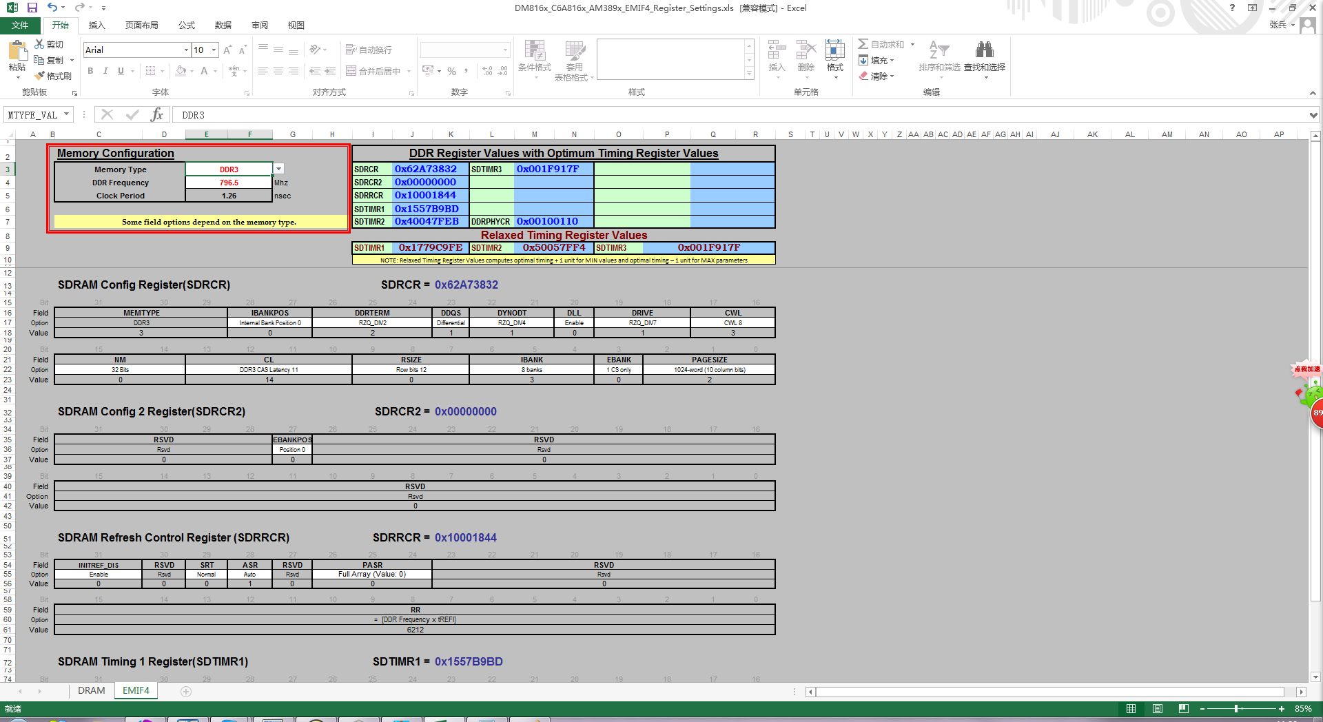

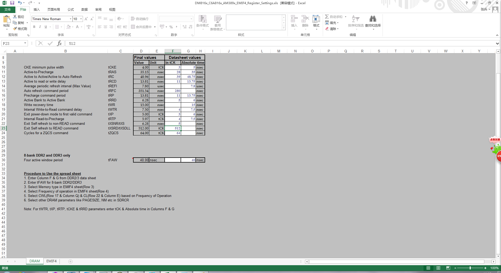

我用的内存型号是4BE77 D9PZQ.
请问这个在GEL文件当中该如何设置这个内存型号的时序,谢谢!
