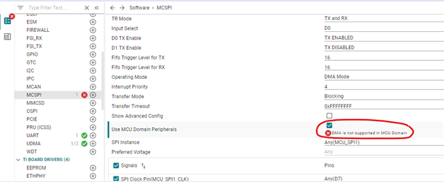

2. Does the M4 core's SPI support DMA functionality? The manual mentions it, but the IDE indicates that it cannot be used.
