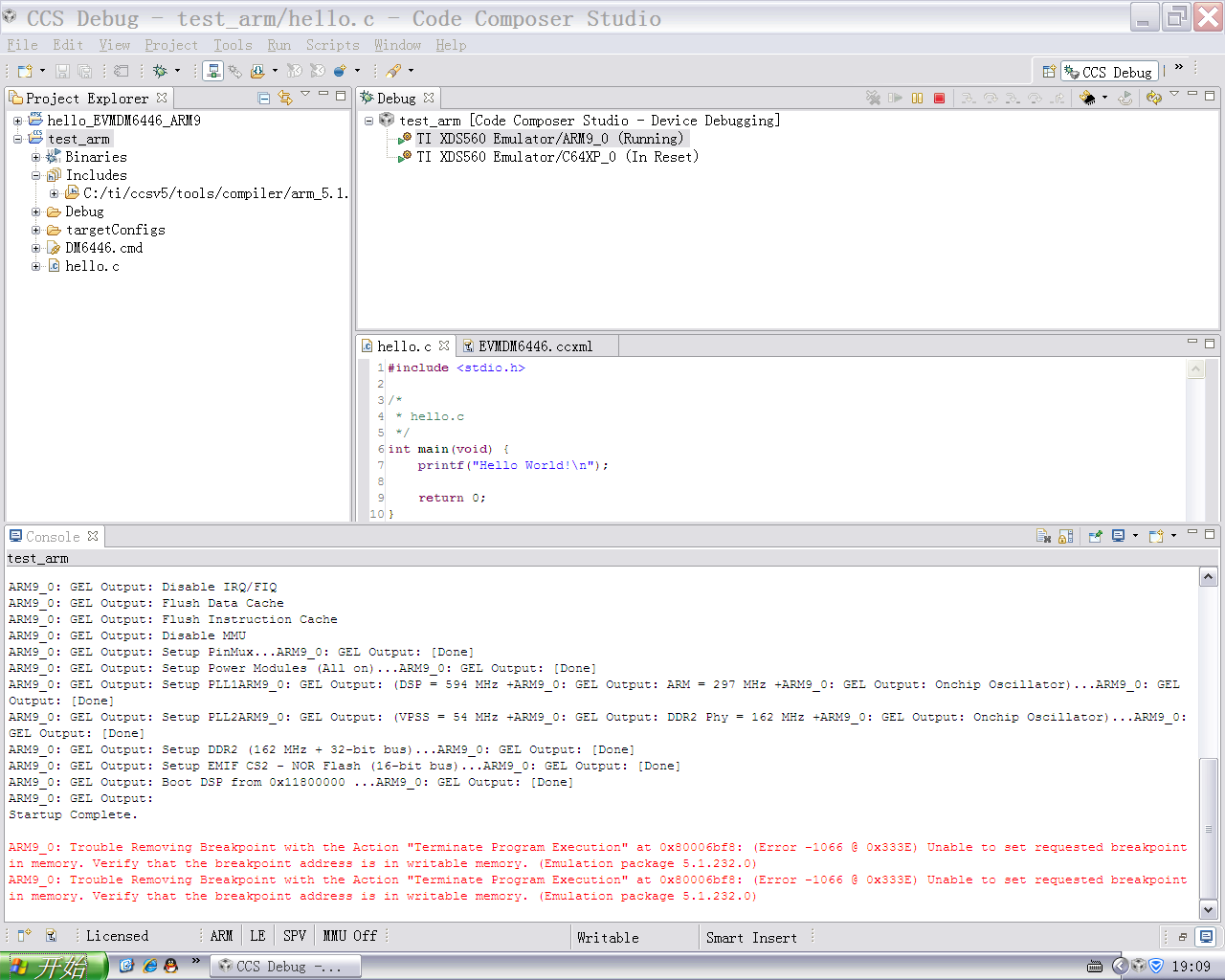

谢谢您的回答,再问一个问题,现在dsp,arm,都连上了,但是调试中点load后就出现了报错信息如下:
ARM9_0: Trouble Removing Breakpoint with the Action "Terminate Program Execution" at 0x80006bf8: (Error -1066 @ 0x333E) Unable to set requested breakpoint in memory. Verify that the breakpoint address is in writable memory. (Emulation package 5.1.232.0)
我是初学者,看不太懂是什么问题,期待您的回答,谢谢!
你好,
你能否先参考一下DM6446 EVM的CCS测试例子?
