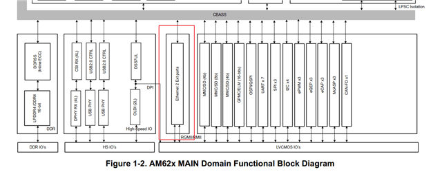

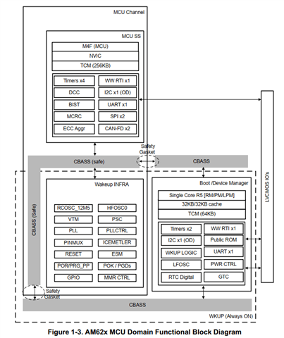

如题,想了解一下M4能否访问到以太网,查看手册两者(MCU DOMAIN和MAIN DOMAIN)都通过CBASS连接外设
M4F通常用来做safety processors,很少做micro controller functionality,没有M4F访问网口的驱动。请看下面的帖子。
https://e2e.ti.com/support/processors-group/processors/f/processors-forum/1270103/am625-gpmc-linux-driver-spi-and-pwm-m4-example/4809861
https://e2e.ti.com/support/processors-group/processors/f/processors-forum/1257666/am623-peripheral-access-from-mcu-domain-and-main-domain
