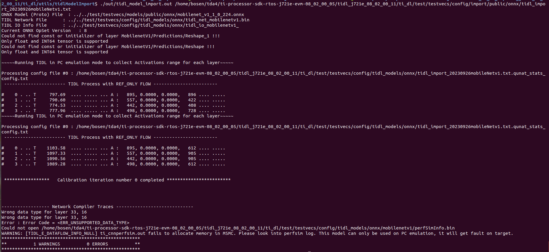

1、shufflenet_v2的ONNX模型在转化bin文件时,报错:“ONNX operator ReduceMean is not suported now";
2、mobilenet_v1的ONNX模型再转化bin文件时,报错: ;
3、yolop的ONNX模型再转化bin文件时,报错:“ONNX operator Div is not suported now ;ONNX operator ScatterND is not suported now”;

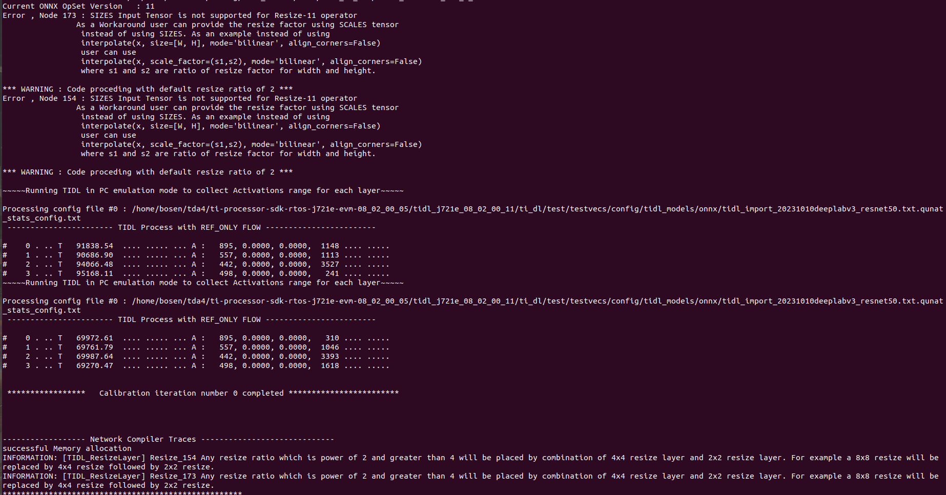

4、deeplabV3_resnet50的ONNX模型再转化bin文件时,报错:“ “;
